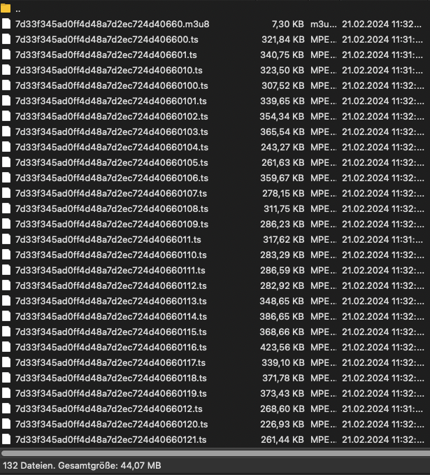

    Hi, I'm using Jellyfin 10.8.13 via the repository on Debian 12.
    When I try to play a video (no matter which) I see the background image with a loading circle (and after some time the screen went black, only on the Cromecast) but never a video. I see that the transcoding is working, files are created.

    Since I can see the server creates transcoding files, I assume I have no problems with permissions.
