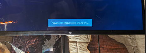

    Hello!
    I am running JellyFin 10.10.7.  I tried upgrading to the new version, but I was having issues with it eating up 100% of my CPU immediately.
    My question is, when i go to play a channel on live TV, I initially get "Player error encounterd.  Will retry",  Then the channel will pop on.  I do not see this on the PC, but all of my firesticks, rokus, etc do this.
    Not a really a huge problem, but wondering if there is a fix.  I have cleared the cache and reinstalled on my sticks.
    Logs don't show any issue on server end.
    Update! It appears to only happen when I play the channel from the actual guide. If I'm watching something and I hit down, then choose a channel from there, I do not get the error.
    Solved! Firesticks have transcoding turned off by default. Turned it back on, good to go!
    Thanks!
