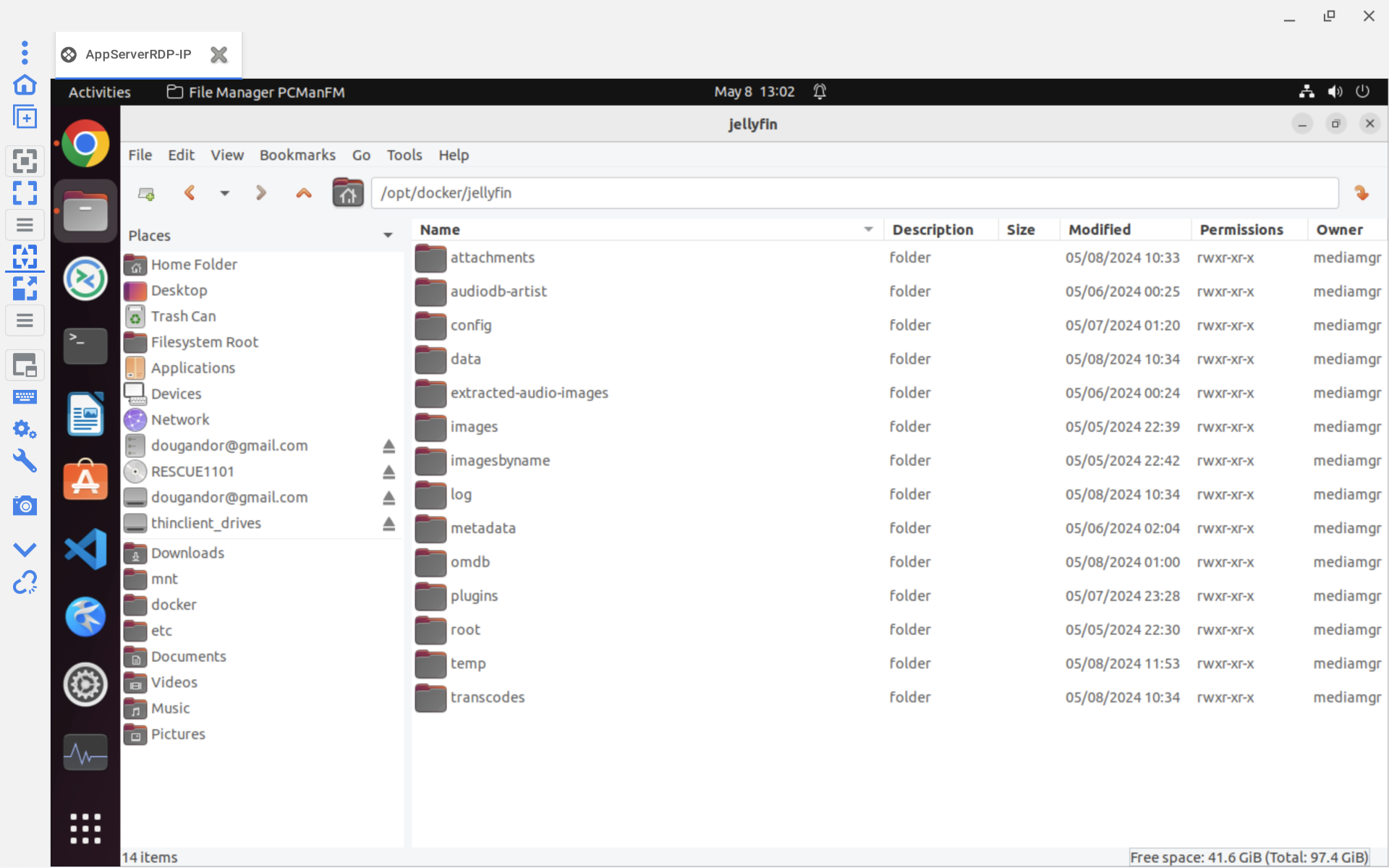

    You are correct sir.... That I do...   Thank you!!    See folder structure below.  I have both cache and config set to /opt/docker/Jellyfin.    However, I guess I don't understand why cache cleanup would clear the plugins folder, but not the data folder where the database is located.   Also, how is it retaining the plug-in configuration?    I guess I'll repoint my cache to /opt/docker/Jellyfin/cache and leave config at opt/docker/Jellyfin.

    Seems reasonable. Do you know which folders in my attachment in my post above are cache folders? I wouldn't mind cleaning up my Jellyfin and moving them out of the config folder.

    (2024-05-08, 07:52 PM)DVA411 Wrote: Seems reasonable.  Do you know which folders in my attachment in my post above are cache folders?  I wouldn't mind cleaning up my Jellyfin and moving them out of the config folder.
    This is my cache folder.

    Thanks. What about "extracted-audio-images" and "attachments"? Do you have those in your config or cache folders?
    FYI. I got home today and my plugins were missing again, and I had to reinstall them. I cant be for sure, but I thought I checked to make sure my plugins were present before I nested my cache folders under my config folder and changed my compose file accordingly. I was surprised that my plugins were missing again. I'll give it a couple more days, to see if this was in fact the problem. I find it weird that my new cache folder is empty though. Not sure what initiates cache, but certainly there was some watch and navigation activity this afternoon.
