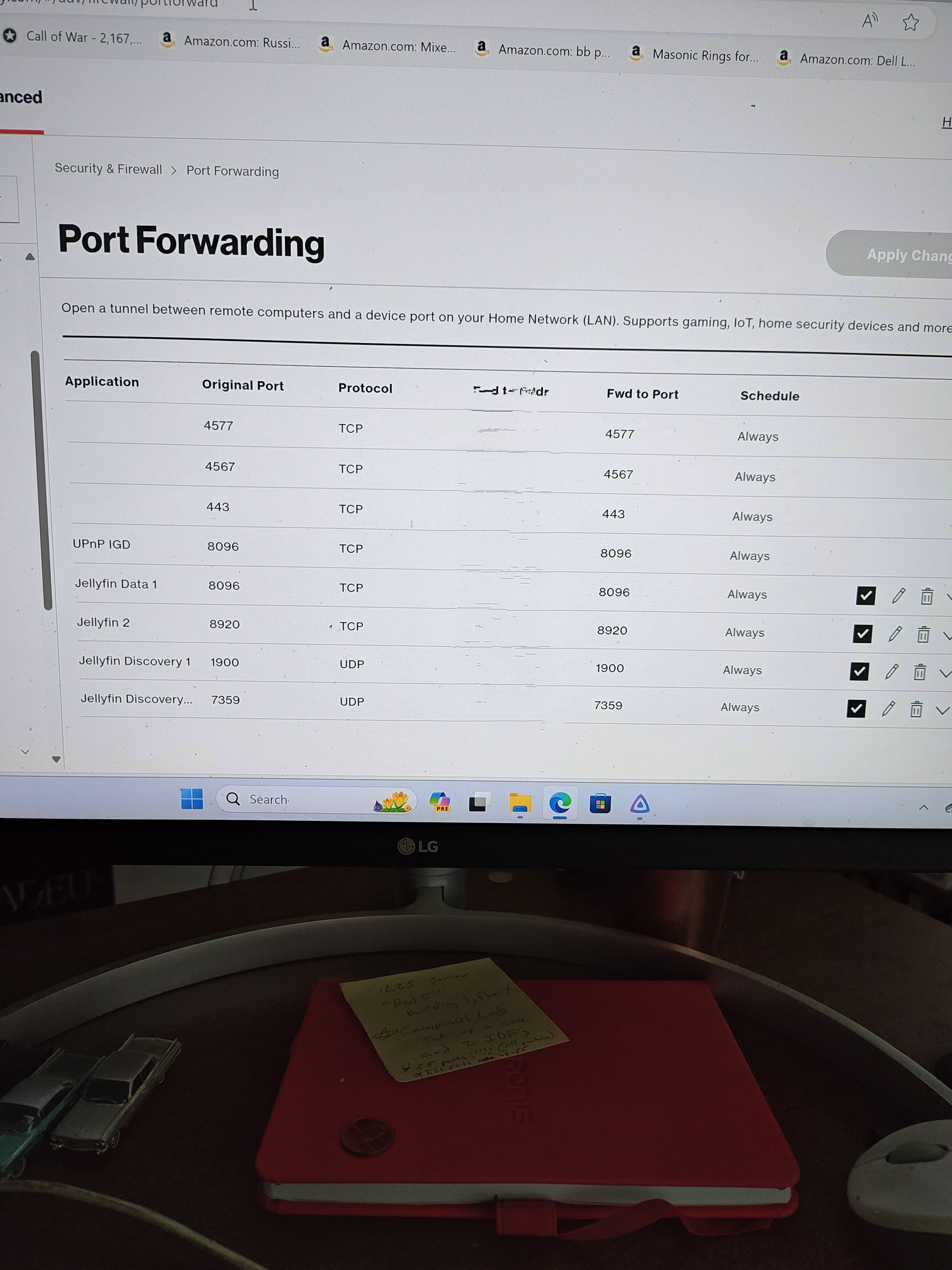

    You don't need to port forward 1900 and 7359. Those are LAN only protocols for DLNA and service discovery, respectively.
    That looks like a Verizon FIOS router, correct?

    Should i get rid of 1900 and 7359? does it really matter thanks you so much! hope ill be getting it running its currently running on windows 11 and is a fios g3100

    i also have automatic port fowarding on- i turned that on and the problem persisted LMK if i should disable it

    You definitely should get rid of the port 1900 and 7359 port forwarding rules.  A) It doesn't work externally anyway and B) exposing them to the Internet is a security risk.

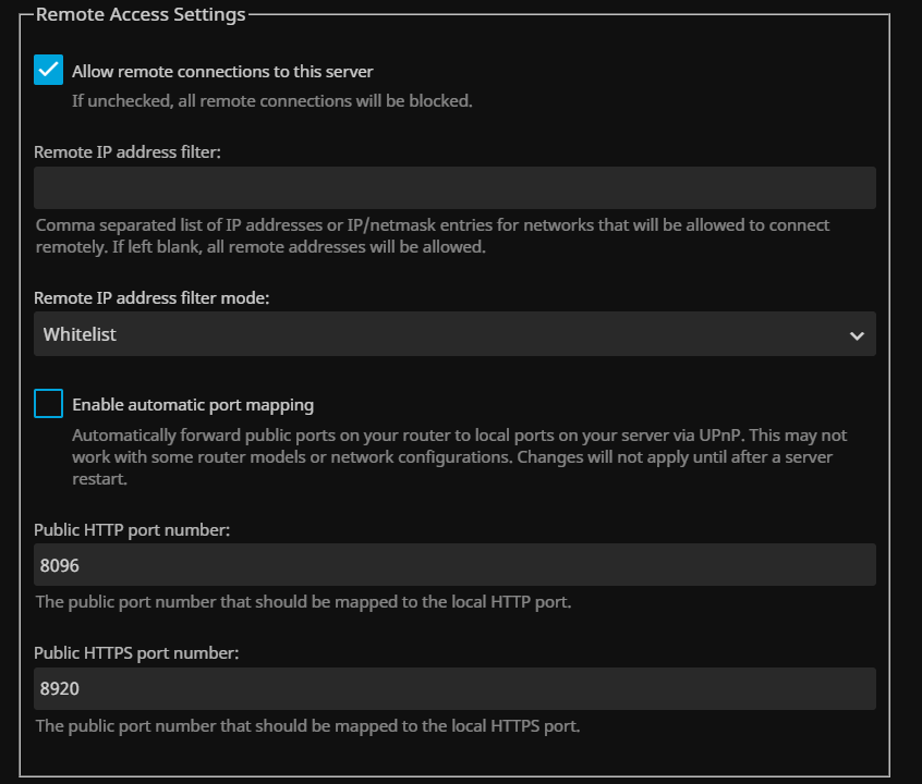

    Definitely turn off automatic port mapping. It is not needed if you manually setup port forwarding. Are you able to access your Jellyfin locally?  Did you enable "Allow remote connections" in the Jellyfin networking dashboard?

    yes i can acess locally on network with phone and laptop- should i disable IPv6 Aswell? i enabled that too remote connections is on. i i turned off IPv6 to get back to defaults. i removed those ports from my verizon router and turned off automatic port mapping and turned off and turned on sever

    (2024-03-13, 11:20 PM)Jack Wrote: yes i can acess locally on network with phone and laptop- should i disable IPv6 Aswell? i enabled that too remote connections is on. i i turned off IPv6 to get back to defaults. i removed those ports from my verizon router and turned off automatic port mapping and turned off and turned on sever
    (2024-03-13, 11:04 PM)TheDreadPirate Wrote: You definitely should get rid of the port 1900 and 7359 port forwarding rules.  A) It doesn't work externally anyway and B) exposing them to the Internet is a security risk.
    here is screenshot
    also after doing this i still fail to connect on my phone off cell service
