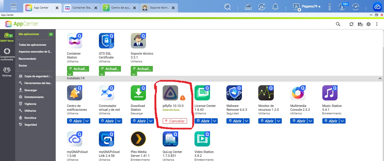

    I have a Qnap ts-431k with an alpine Arm 32bit processor.
    Install Jelyfin version 10.10.0 and even 10.9.11
    But both give me problems, recently installed, everything works very well, I can watch series, movies and so on without problems on all my devices.
    After 12 or more hours, Jellyfin turns off, it cannot be accessed from the server that never turns off, nothing I do seems to make it react, it won't let me turn off and restart, it won't let me uninstall, the only solution is to restart install the version and only then it works again for a few hours before failing again.

    If I ask for help to configure Docker because apparently it doesn't die at midnight, while the version 10.10.0 that passes the capture in the post above keeps dying and once it dies it doesn't respond, you have to reinstall it again and again. again to revive it.
