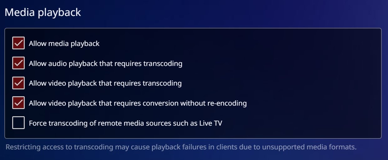

    It doesn't matter if it doesn't play it, before I had it like this on another service and 90% of the content is played without problem for the majority
    If it can be deactivated, I would be interested to know how.
    You have to re-encode with the codecs and containers I stated above.
    Is that done within jellyfin?

    I can't do that because it's a lot of content and it would take a lot of time, but everything is in mkv which allows it to be played on all devices.
    Can't you cancel the transcoding of everything even if that means some content can't be played?

    (2024-08-21, 08:39 PM)franciscok Wrote: Can't you cancel the transcoding of everything even if that means some content can't be played?
    Yes, this is a per-user setting. You need to go into the dashboard and into each user's profile settings to disable the appropriate settings for them there.
    The option "Allow video playback that requires conversion without re-encoding" is the option that enables remuxing to happen.
    Just uncheck all three options (the two for transcoding, and the one for remuxing).
    Doing so will result in your users getting denied when attempting to play a video that's not supported on their client.

    You can disable transcoding, but then your users may not be able play some videos on some of their particular devices. MKV is just a container. The codec of the video, audio, and subtitles are what matter.

    Yes, I have already disabled the video, the one that causes problems is the audio, if I disable it it doesn't play...
