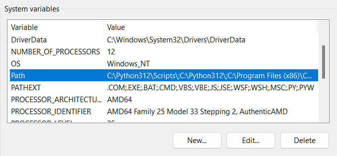

    The only thing in my environmental paths having anything to do with Jellyfin is this
    [Image: 0e793378019fa1fc00c605d9b542023d.png]
    Posts: 537
    Reputation: 28
    #19

    2024-08-30, 01:21 AM (This post was last modified: 2024-08-30, 01:25 AM by theguymadmax. Edited 2 times in total.)
    (2024-08-30, 01:04 AM)Dex Luther Wrote: The only thing in my environmental paths having anything to do with Jellyfin is this
    It would have an entry in the path variable, click edit to see the full list. Check both user and system.
