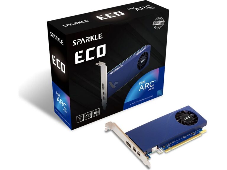

    Sparkle just released a line of low profile Arc GPUs. Their A310 model is the only one that would fit in a 1U chassis.

    (2024-01-23, 09:13 PM)TheDreadPirate Wrote: Sparkle just released a line of low profile Arc GPUs.  Their A310 model is the only one that would fit in a 1U chassis.
    Whoops typo. It's a 530 so it's actually 2U. But the problem is the way the daughter card is laid out, it only accepts a 1-slot GPU so that A310 wouldn't work.

    This wouldn't fit?
    https://videocardz.com/newz/sparkle-intr...ofile-gpus

    (2024-01-23, 09:32 PM)TheDreadPirate Wrote: This wouldn't fit?
    Oh that totally would! Thanks! When I searched I saw the pic for the 380, which wouldn't fit.
