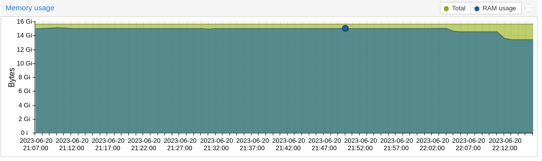

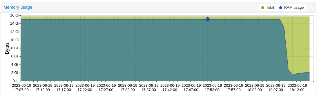

    I've been noticing that RAM usage will continue to climb until it's completely full and then never goes down. I feel like this is causing my instance to freeze up after a few days and not play anything to anyone. This doesn't feel normal for a ubuntu installed vm.
    all that I mostly see in the logs is
    [2023-06-19 23:29:01.852 +00:00] [WRN] As of "06/19/2023 23:28:47 +00:00", the heartbeat has been running for "00:00:14.1240388" which is longer than "00:00:01". This could be caused by thread pool starvation.

    Making that change it did take longer for the ram to fill up. It does at least appear like it's going down when no activity is present on it, but to still get as high as 16G? that still seems much to me. I have included a new batch of logs on this reply.
    .zip   logs-06-20.zip (Size: 24.53 KB / Downloads: 127)

    Are you sure that graph only shows jellyfin memory and not "overall" system memory?
