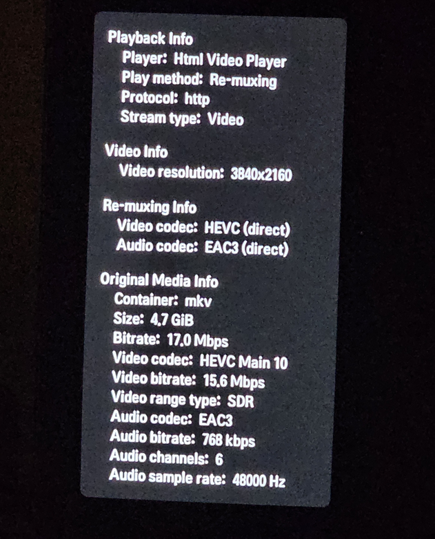

    Hi!
    I switched from a Samsung TV to a LG C9 OLED (WebOS 4.9) recently. I installed the WebOS app to the TV from the Github repo (https://github.com/jellyfin/jellyfin-webos). I'm running Jellyfin (10.8.13) in docker on a vm under Proxmox. With the Samsung TV there were no problems/issues with the Tizen client.
    Now when I start watching a video file with the app on the TV it starts re-muxing which is not really working and I only hear the audio or have other problems. I noticed a big jump in I/O delay in Proxmox when re-muxing starts which can be the cause of the problems. This could originate from some mistake from my end putting together the virtualization setup but since I don't have any problems with direct playing and didn't have any with the Tizen client I now want to focus getting the app direct playing (if possible).

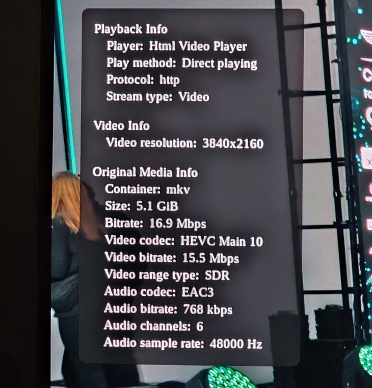

    Since I read that the app is really just a wrapper around the web player I opened Jellyfin with the TV's browser, when I start the same video everything working fine, there is no re-muxing or other issues. I attached two screenshots playing the same video, one is with the app and the other is the browser. You can see with the browser it is direct playing. I checked the settings in the app but could not find anything what can fix this.
    Is there a specific reason for this or can I change some setting somewhere to get rid of the re-muxing in the app?

    I'm playing the exact same video file in both screenshots, the container is MKV.

    No, I'm using the same TV. One screenshot is with the webos app other is the built-in webos browser on the TV.
