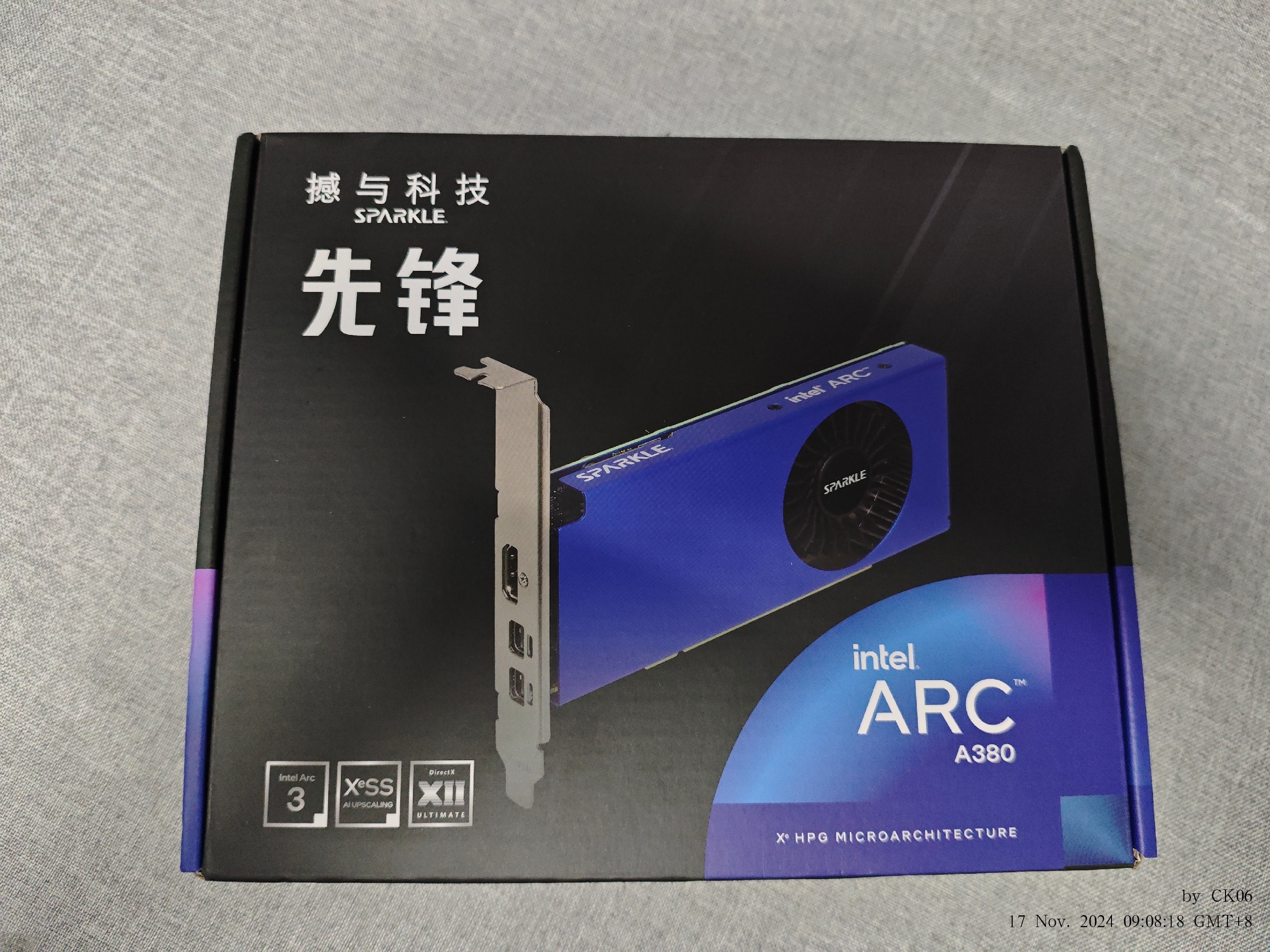

    Thanks for the info, I have found a China (or Asia?) exclusive single slot A380 card with 6GB VRAM at taobao and ordered already via superbuy.
    The cards model is the "Sparkle Arc A380 Pioneer".
    The seller I bought from: https://item.taobao.com/item.htm?id=795843468467
    But this seller only has 4 units left.
    Another seller with same price is: https://item.taobao.com/item.htm?id=802579882774
    It seems to be the only single slot A380 available and also only in China as far as my research goes. That exclusive "Pioneer" variant seems to have a better/bigger FAN and is also even a shorter card than the Sparkle Arc A310 ECO.

    For anyone interested regarding the Sparkle Arc A380 Pioneer, here are photos of my box. (Still in China at the Superbuy warehouse.)
