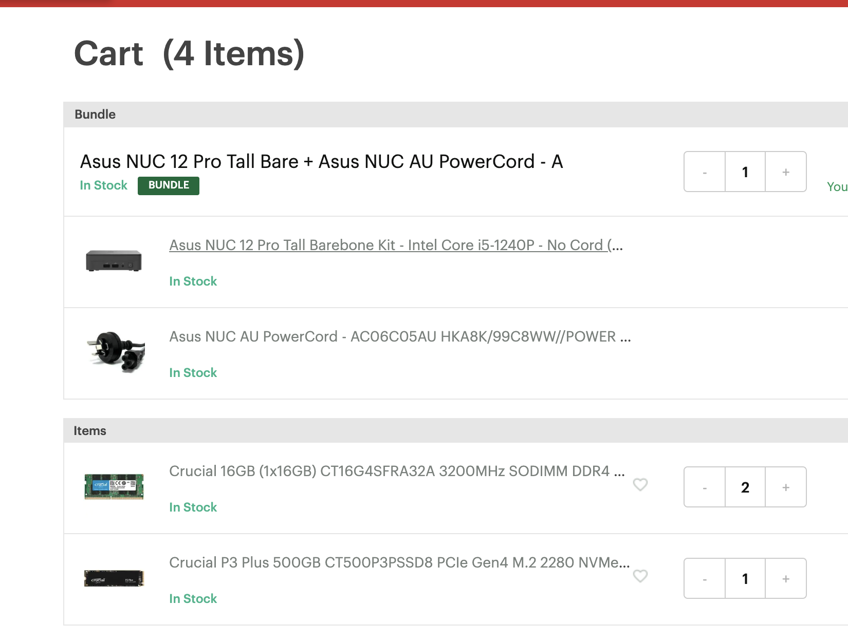

    My fine senior Jellyfish, I am seeking some advice/thoughts on a potential setup I am planning. Pitfalls, issues, advice, etc.
    The plan is:
    Jellyfin server host running on an Asus/Intel i5-1240P NUC, 500GB M.2 Crucial P3 Plus HD, 16x2 Sticks of Crucial 3200MHz RAM.
    Connected to an Asustor Lockerstor NAS set up with TrueNAS.
    My Internet plan is 50/20 but would like to upgrade that.
    Looking to play 4K HDR 10-bit H.265 MKV files to an LG G3 upstairs but would like to have the capacity to handle multiple streams.
    Sonarr, Radarr, Jackett, Overseerr
    Questions:
    #1 - Does this sound like a functional setup? Is it the way?
    #2 - What OS should I use? Leaning towards Linux/Ubuntu (In IT but little experience with those OS)
    #3 - Any tricks to get Intel Quick Sync to lend a hand with transcodes?

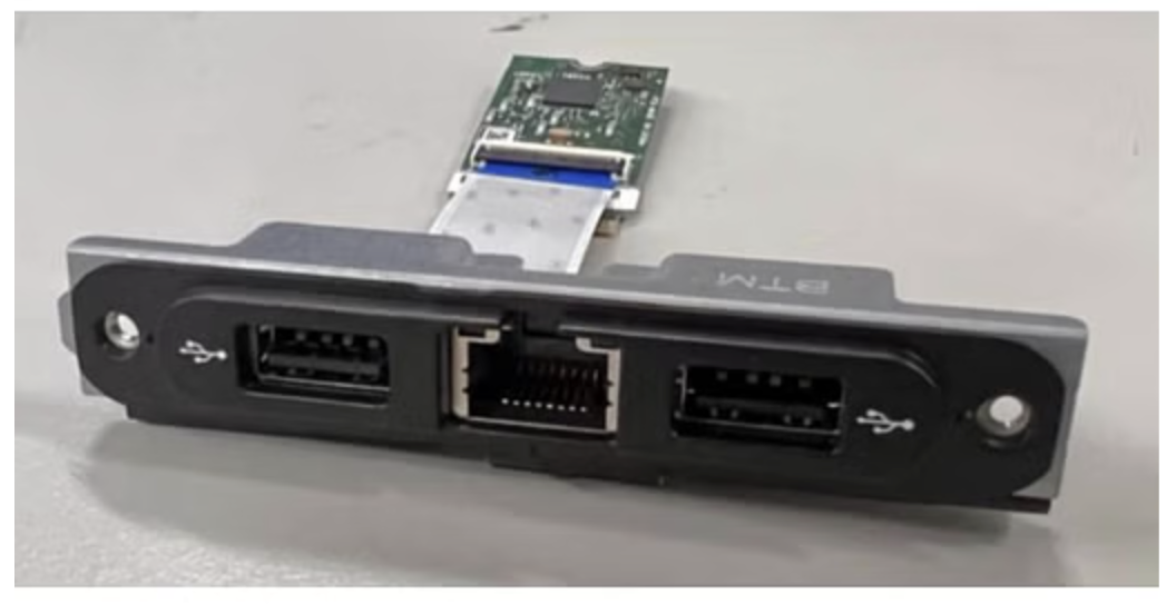

    #6 - Should I get a LAN add-on module for the NUC so I can connect it that was to NAS, or USB to ethernet adapter?
    E.g. https://www.jw.com.au/product/intel-lan-...o-tall-mdl

    To your questions:
    #1 yes
    #2 if you are new... proxmox has a webgui Winking-face
    #3 gpu passthrough via proxmox is easy this days and qsv is supported by jellyfin

    #6 I don't think a separate network link to the nas is really needed.

    Well I don't really see the point of buying a 1k+ NAS if all it does is providing storage for a linux/proxmox/docker host. Why not build the storage into your server?
    Local storage is almost always faster/cheaper.
    Also the i5-1240 might struggle beyond 2-3 4k transcoded treams. If you can directplay that should be no issue.
    How about:
    8840hs SOC, Intel arc 310, put that + the hard disks into itx chassis of your choice.
