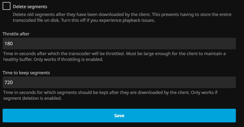

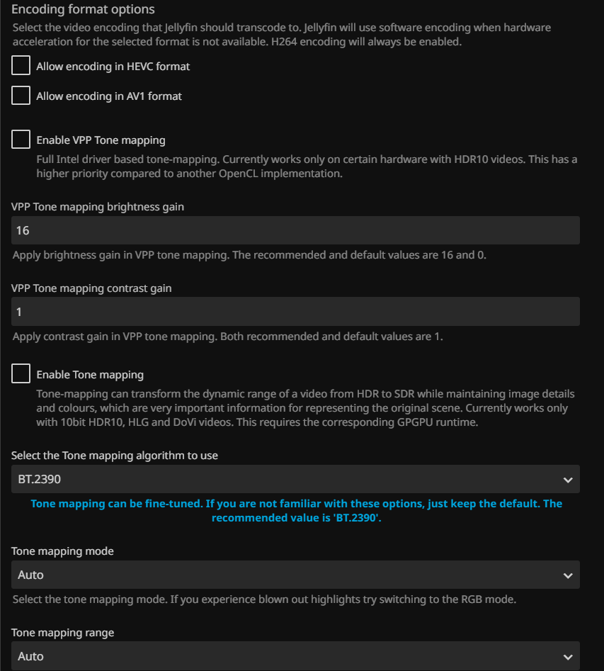

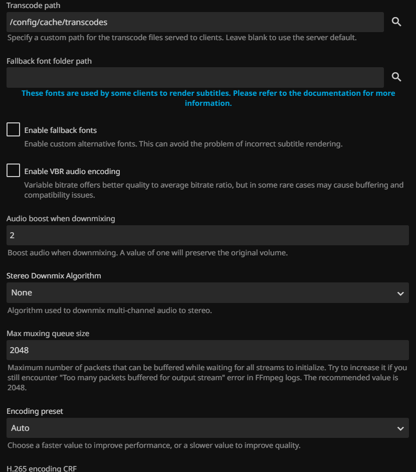

    Dashboard pics below:
    I've mostly left everything default except for the first part.
    2024-08-23, 12:57 AM
    The iGPU on the CPU is the part with Intel Quick Sync and that still requires you to pass that GPU into the container.
    Stop the container in unRAID. Open the docker config for the container. Go to the bottom and click on "Add path, port, variable, label, or device". Add a device and in the box enter "/dev/dri/renderD128". Save. Start the container.
    In Jellyfin, go back to Dashboard > Playback. You can check "Enable encoding in HEVC format" as well as both tone mapping check boxes. I'd also recommend checking "Throttle transcodes" and "Delete segments".
