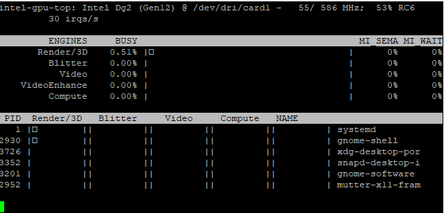

    So I looked  at the intel tool for GPU usage before transcoding
    And during
    And the transcoding via ffmpeg is using up 100% of the compute engine
    Below is the transcode log for an AV1 file
