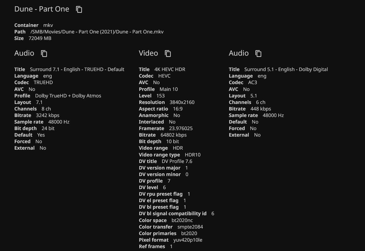

    • One 4K HDR file, The Green Knight, displays a black screen while streaming on the Fire Stick, but the audio continues to play. The video player interface completely disappears while this happens. The Jellyfin dashboard says it's direct streaming.
    • Other HDR content like Dune plays perfectly fine on the same setup, with virtually the exact same video media info, minus the bitrate. See attached images.

    Exoplayer, which is what our AndroidTV app uses underneath, is supposed to fallback to DV8 or HDR10 for DV7.6 content, but doesn't. This is a known issue with exoplayer.
    Your options are to use the quality selector in the AndroidTV player to select a lower bit rate than the video's native bit rate. Looks like these videos are between 60-70Mbps, so selecting 50Mbps would trigger a transcode.
    Your other option is to strip the Dolby Vision portion and make your video straight HDR10 since Dolby Vision 7.6 and 8 are built on top of HDR10.
