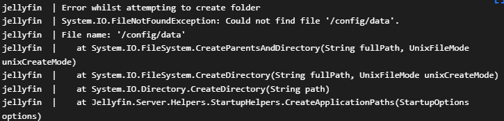

    this is the log that come with it, how do i fix this?
    2024-06-01, 05:34 PM
    For the folder you mounted /config to, you need to make sure that the user the container is running as has read and write permission to it.

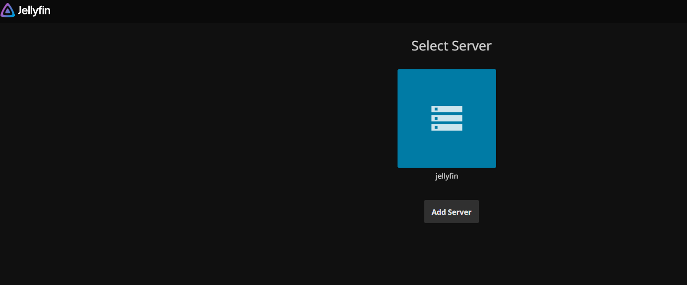

    sylrus
    Country:Indonesia
    2024-06-02, 09:51 AM
    this is what happen when i enter jellyfin through casaos now, but i cannot connect to the server, i just install portrainer, and it said administrator isn't allowed for jellyfin
    2024-06-02, 03:29 PM
    Try clearing your browser/app cache.

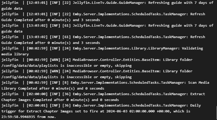

    2024-06-03, 06:03 AM (This post was last modified: 2024-06-03, 04:22 PM by TheDreadPirate. Edited 1 time in total.)
    still cannot access
    this is my log :

    2024-06-03, 04:23 PM
    Try switching the networking mode for the jellyfin container to host networking.
    sylrus
    Country:Indonesia
    2024-06-03, 10:35 PM (This post was last modified: 2024-06-03, 10:41 PM by sylrus. Edited 1 time in total.)
    how to do that? done, changing to host work, thx for the solution
