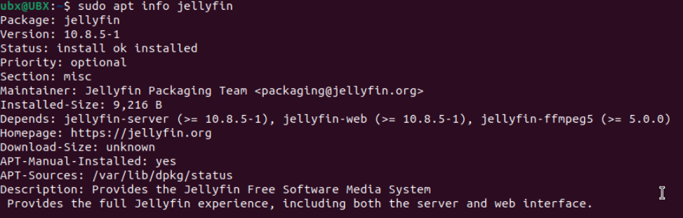

    Hi - hoping to get some support as I've been having issues updating my server.
    My current Jellyfin setup is a server running on Ubuntu 22.04.4 through Proxmox, and I usually browse my media library from the app installed on my Amazon Firestick.
    I've had an alert pop up when I open my app on Firestick for a few weeks now, saying "Update your server from 10.8.5 to at least 10.9.0 to continue using the app after the next update". But when I check in Ubuntu / try to update the server using
    sudo apt install
    I get a message saying that Jellyfin is already in its latest version (screenshot attached).
    Anyone else having this issue or know how to solve it? I'm just afraid I won't be able to access my library from the app anymore, unless I manage to update.

    What is the output of the following command? You may need to reinstall the Jellyfin repo.
    cat /etc/apt/sources.list.d/jellyfin.sources

    (2024-06-11, 03:26 PM)crobibero Wrote: What is the output of the following command? You may need to reinstall the Jellyfin repo.
    Thanks for your reply. I'm getting "No such file or directory" as output. How do I reinstall it if when I prompt the installation I get told I'm already using the latest version of Jellyfin? Will I need to uninstall it and reinstall again?

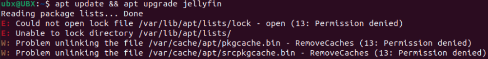

    Repo reinstallation was successful, however when I run
    apt update && apt upgrade jellyfin
    I get the attached errors

    (2024-06-11, 05:07 PM)AlexanderSupertramp Wrote: Repo reinstallation was successful, however when I run
    You need to be root, or run using sudo.

    Thanks all it worked!!
