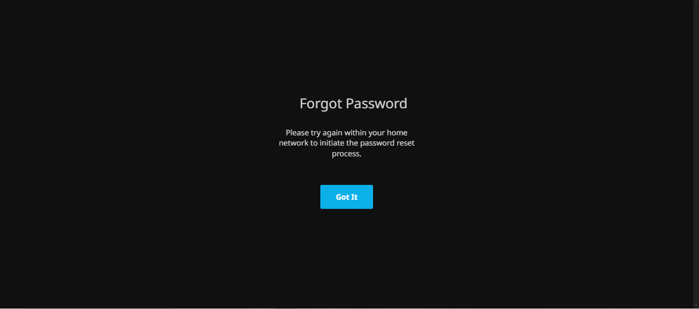

    I tried the forgot password button but received a popup that told me to be connected to my home server before trying to reset the password. I'm not sure what this means. As far as I'm aware, I haven't changed servers or anything so I don't know why I get that.

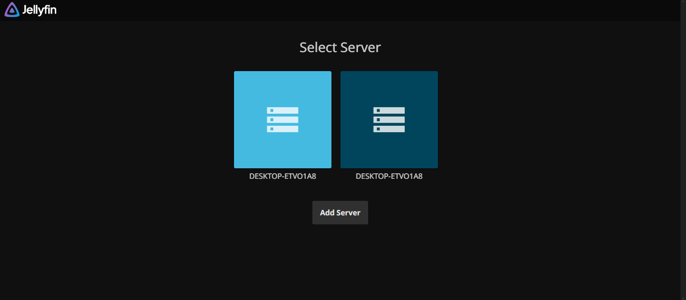

    I uninstalled and reinstalled Jellyfin but still could log in. And my PC shows up twice now.

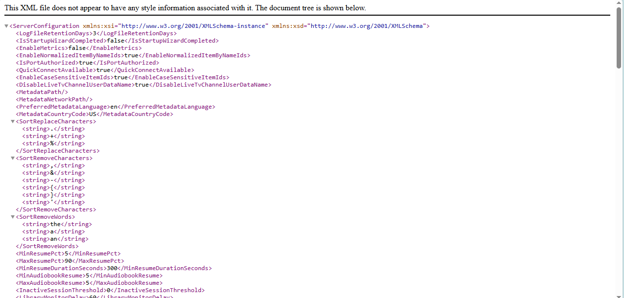

    I also attempted to do the solution of going into C:\ProgramData\Jellyfin\Server\config and while it did lead me to the xml file its an internet link and it already says my wizard install is set to false. Not sure if I'm doing that right.

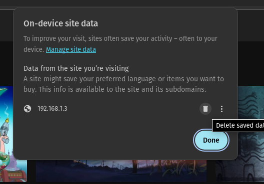

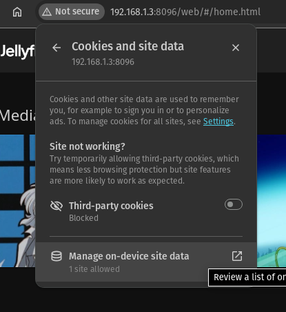

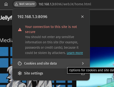

    Clear your site data for Jellyfin or use an incognito window.

    That worked. Kinda annoyed I didn't think of something that simple lol. Much appreciated!
