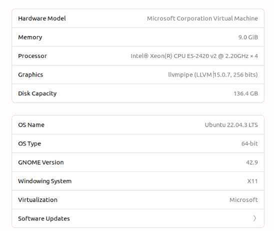

    I'm fairly new to self-hosting so please let me know if there are better ways for me to set this up.
    I've recently set up a Ubuntu VM  running with 4 cores and 8 GB RAM with dynamic RAM enabled. These are the specs:
    It's hosted by Hyper-V on a Windows Server 2012 R2 device that has a 6 core Intel Xeon E5-2420.
    Media is stored on a Synology DS412+ and mounted to the VM via. NFS.
    Navigating the UI is completely seamless and my other containers work completely fine so I don't believe its a networking issue, issues only occur when I open a video to stream.
    It will take approximately 30 seconds to start a show which would be fine however it then continues to buffer once every 2 seconds and I'm not sure how to fix it.
    Some extra things to note:
    - hardware acceleration is not turned on, I looked briefly into it as a potential solution however found that my CPU does not have integrated graphics and I'm missing the /dev/dri folder which I haven't been able to fix
    - My server is currently hooked up to ethernet via. powerline adapter due to physical constraints near my router, however performance in all other areas seems to be find so I don't believe this is the main issue
