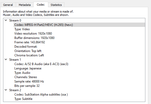

    Upon further testing, it seems that some shows are able to play with no issues at all, I'll post the Codec and bit rate info of each and say if they are working (please let me know if I miss some info and I'll grab it).
    Also just an FYI I am using the Jellyfin media player for all of this troubleshooting:
    This one is working completely fine:
    This one is one that constantly buffers:
    This one also works completely fine using the same encoding as the one above:

    Both of the videos are direct playing.  The one that buffers has a higher bit rate, but 5Mbps is an average video bit rate.  BUT, using powerline ethernet can be problematic.
    Things might be "fine" everywhere else, but streaming is a packet loss sensitive task.  You should double check the quality of the connection.  I'd choose good WiFi over powerline ethernet.
    I reorganised the space around my router and managed to get a direct connection hooked up, it instantly fixed all the problems.
    Thanks heaps for the tip!! I didn't realise how unreliable powerline connections were.
