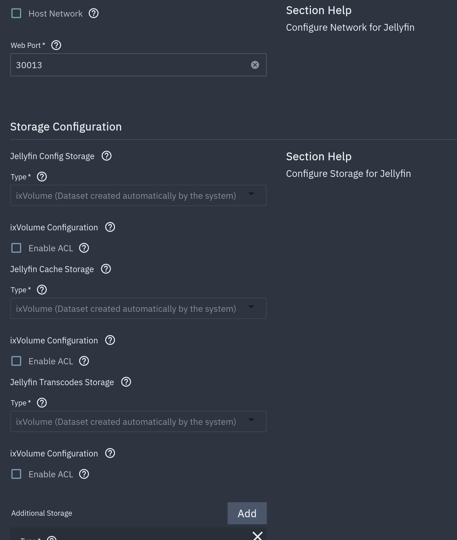

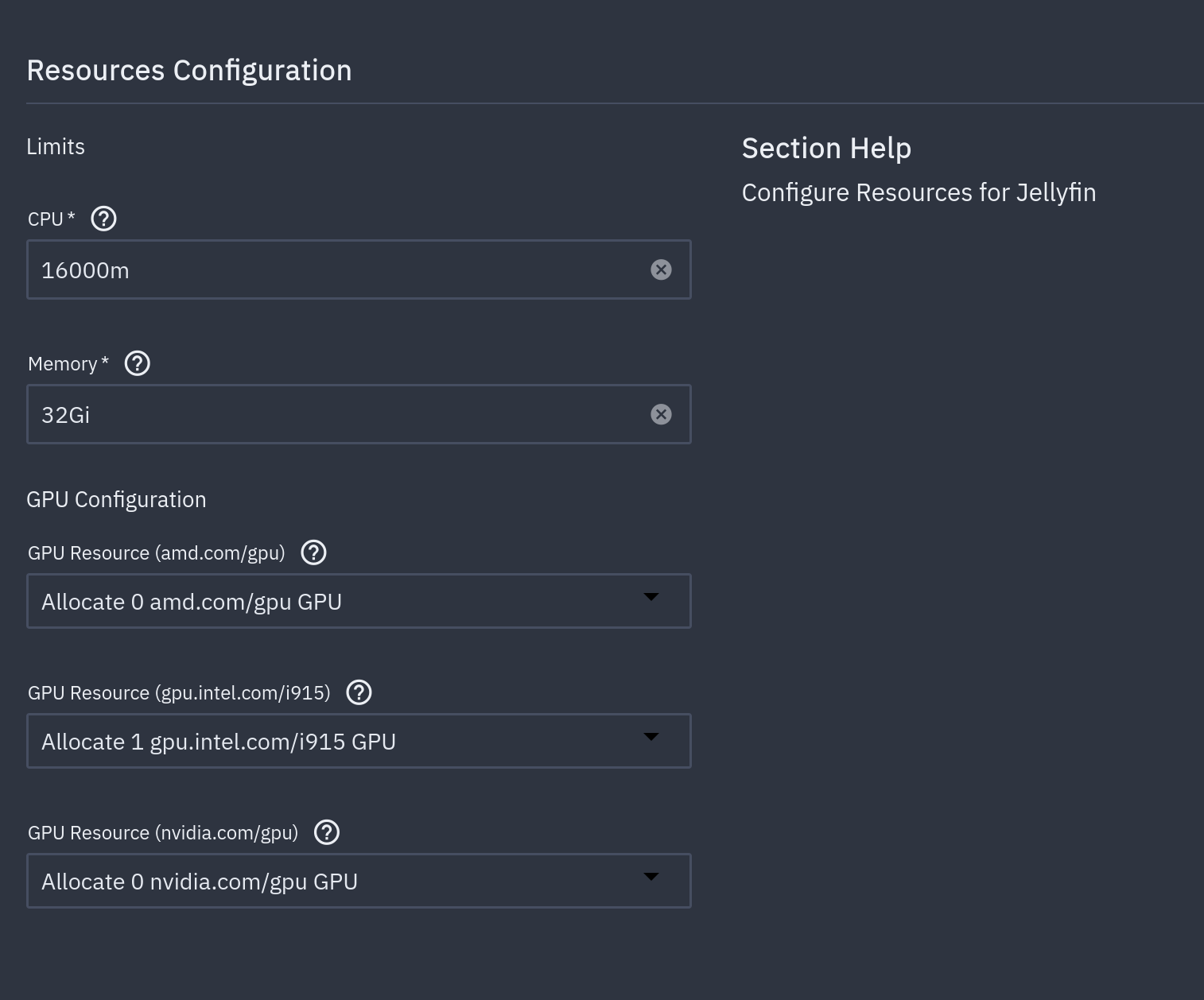

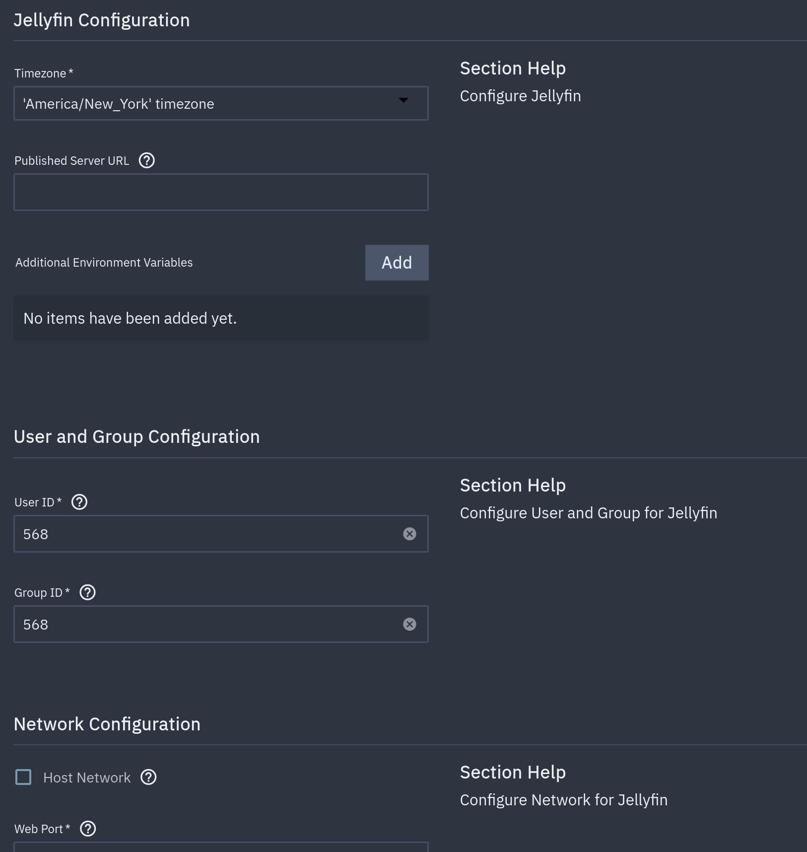

    BourbonDoc
    Posts: 31
    2024-09-27, 05:57 PM (This post was last modified: 2024-09-27, 06:01 PM by BourbonDoc.)
    Pretty much stock. I've tried it on "Host Network" and not. I usually run it with Host Network off. This config works no problem on a fresh install and had been working fine for about a month before a power outage gave me a new IP from my ISP. Then it happened again when one of my kids unplugged the modem, and now with hurricane Helene. It's definitely something about the new WAN IP, but I have no idea what.

    2024-09-27, 06:14 PM (This post was last modified: 2024-09-27, 06:15 PM by TheDreadPirate. Edited 1 time in total.)
    Soooo.....what is the problem you are having? The TrueNAS UI says that it is "deploying" constantly? The log looks fine. Is TrueNAS forcing the container to restart because it can't determine its status?
    But I noticed that the bridge IP is different than what you mentioned in the first post.
    Startup probe failed: Get "http://172.16.2.46:8096/health": dial tcp 172.16.2.46:8096: connect: connection refused
    It appears to be using a different address now. Not sure how big your bridge subnet is.
    2024-09-27 13:57:02.005828-04:00[13:57:02] [INF] [1] Jellyfin.Networking.Manager.NetworkManager: Filtered interface addresses: ["127.0.0.1", "172.16.4.181"]
    Also, it looks like you're allowing TrueNAS to manage the container storage. Ideally you would create a dedicated, static space in TrueNAS and use that directory for /config.

    2024-09-28, 04:25 PM
    I mentioned in my last post that you weren't providing a static/permanent path for Jellyfin to store data in. That may be part of the problem. Or may be THE problem.

    2024-09-28, 09:22 PM
    Tried that and it did deploy. There seems to be sticky data in the truenas ix-application storage locations. Unfortunately now I can't get hardware acceleration to work. TrueNAS official and portainer container docker install both have fatal player failures when I try to use hardware acceleration. Confirmed my graphics card (A380) is showing up in dev directory. It also seems to work fine with plex install.
