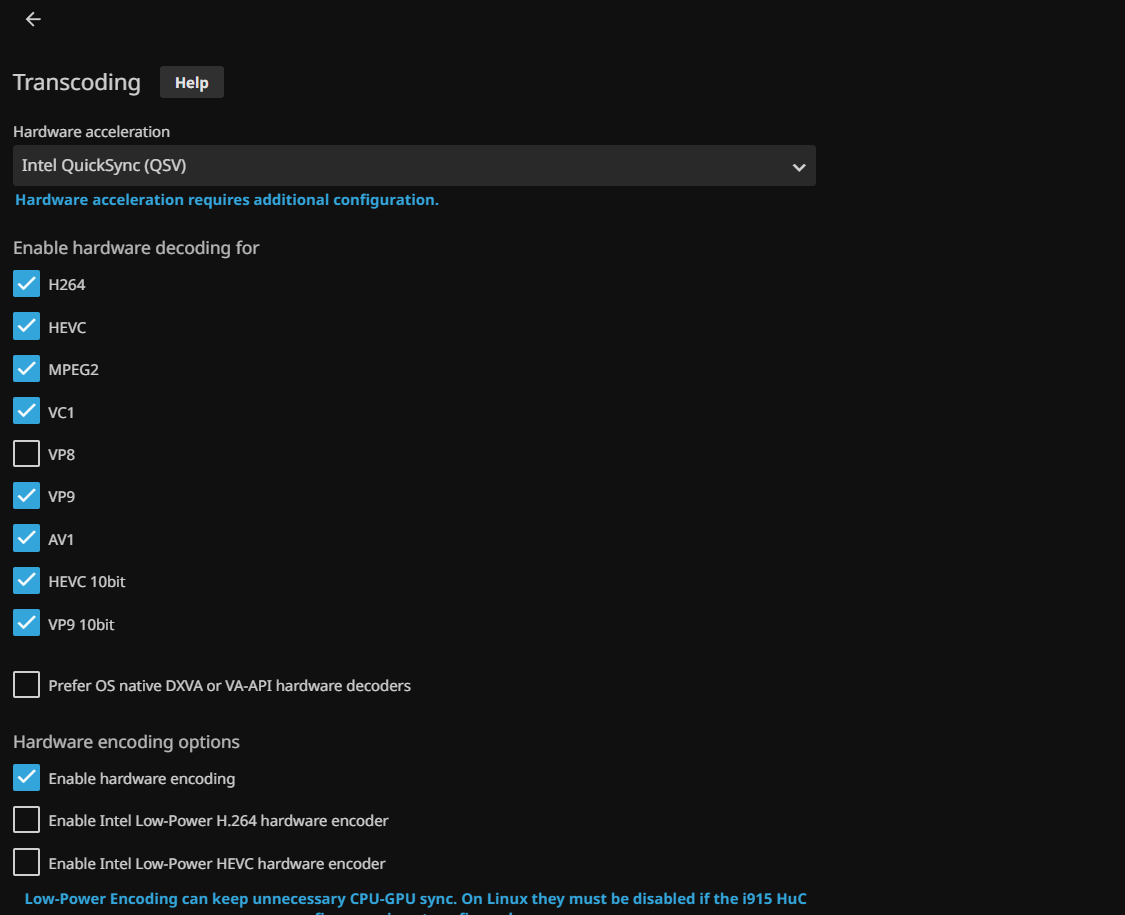

    Hello
    I would like to ask you to check if I have set the transcoding configurations for the N100 processor correctly.
    Thanks
    Vainfo: https://pastebin.com/BHxu3RDT
    Posts: 11,848
    2024-09-01, 02:27 PM
    Yes. But, what version of the Intel OpenCL package is installed and which distro are you running? Run this command and share the output.
    sudo apt policy intel-opencl-icd

    Posts: 11,848
    2024-09-01, 06:07 PM
    Everything looks good.
