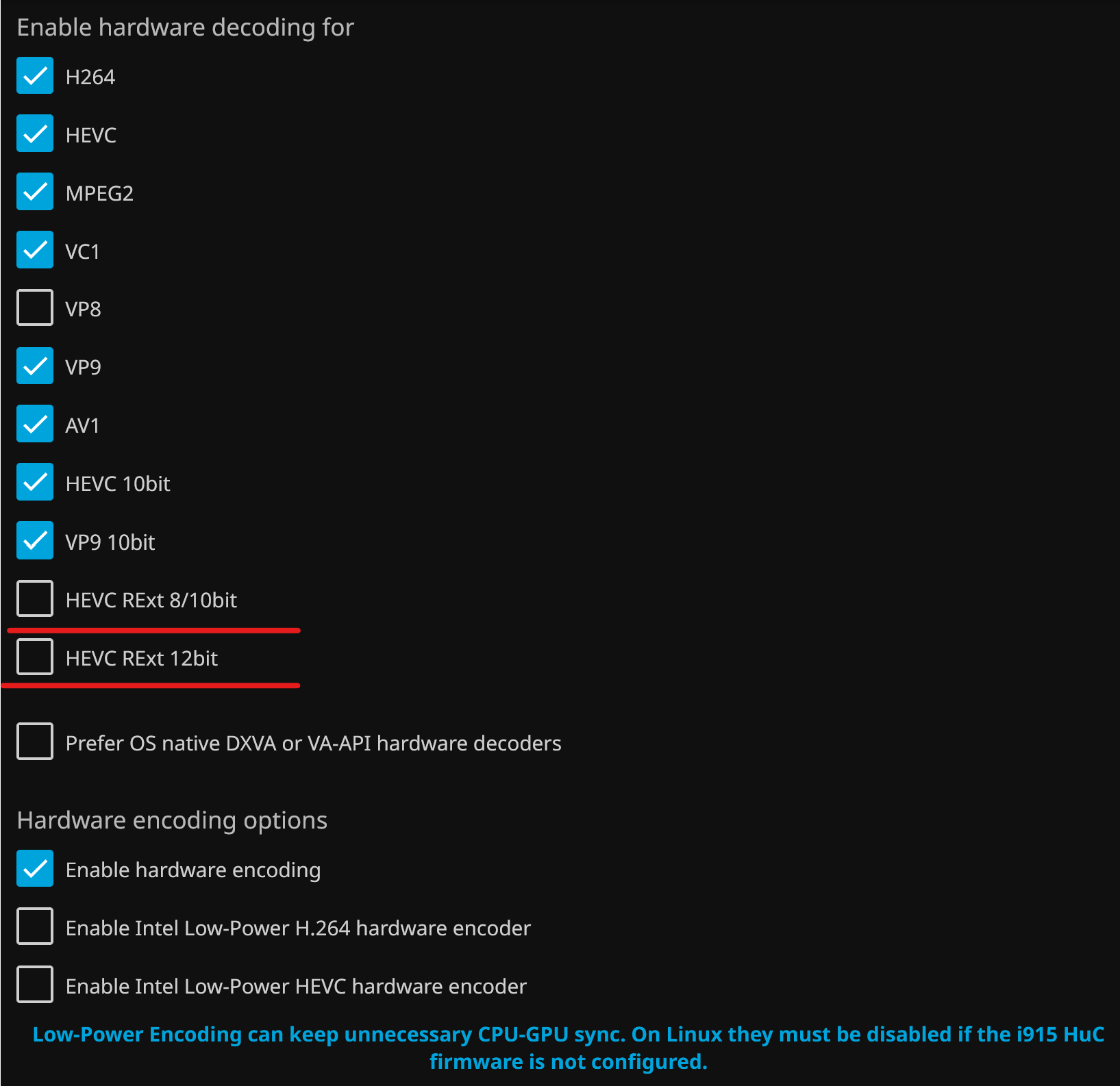

    Hello!
    I just installed Jellyfin Server on an Intel N100 system using Ubuntu 24.04.
    Everything works great, but i have 2 more option available on the Dashboard regarding the supported codecs, that i don't know whether i should enable or not.
    I am talking about "HEVC RExt 8/10bit" and "HEVC RExt 12bit" options.
    Should i enable them on an Intel N100 system?
    Screenshot attached:
    Posts: 11,848
    #16
    2024-12-14, 06:57 PM
    The N100 supports decoding both HEVC RExt options in that list.
