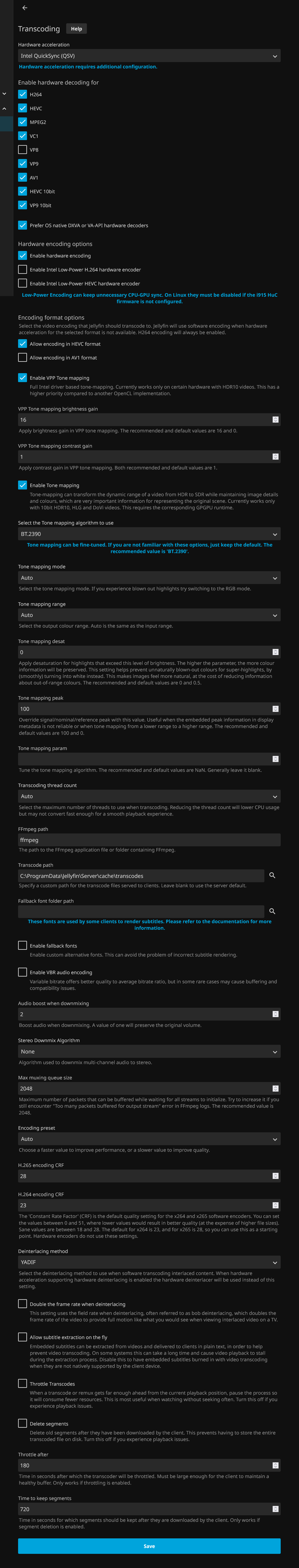

    Hello, I'm experiencing weird issues when trying to play DV content.
    If I try to play it on the browser (SDR) it transcodes, but all I see is a green screen.
    If I try to play it on the WebOs app (DV compatible TV LG C3) the same happens, but then I go back and play it again and the "Dolby Vision" logo appears on the TV and it plays perfectly except for a hideous yellow tint affecting not only the video but the Jellyfin interface too.
    The logs show when I play it on the browser is "transcoding" and when I play it on the TV is "remuxing". I attached the logs (with the video name censored) and my settings.
    Is there a way I can fix this or is this related to my hardware and there's nothing I can do except not using DV files?
    Thank you.
