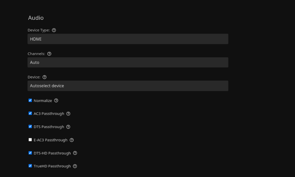

    Hello.
    I have enabled HDMI and passthrough as per below.
    If I enable E-AC3 the client hangs when I play a movie that uses that codec.
    I am using Linux Ubuntu with latest client.
    [Image: jelly.png]
    thanks.
    Bernard.

    I had the same issue. With around 20 device options to choose from, I found that leaving it on "Autoselect device" would cause JMP to hang when trying to play files with non-PCM audio. I had to test each device individually until I found one that didn’t cause JMP to freeze.

    (2024-07-26, 05:44 PM)theguymadmax Wrote: I had the same issue. With around 20 device options to choose from, I found that leaving it on "Autoselect device" would cause JMP to hang when trying to play files with non-PCM audio. I had to test each device individually until I found one that didn’t cause JMP to freeze.
    Thank you very much for your help.
    I have a long list of options, tried them all but if I enable E-AC3 passthrough and play a movie that uses that codec the client hangs.

    Additional notes: The settings I use don't work with the Flatpak version of JMP; they only function with JMP installed directly from the deb packages. I also encountered issues with PipeWire on earlier versions of Ubuntu, but it has been relatively trouble-free with 24.04.

    (2024-07-29, 03:06 PM)theguymadmax Wrote: Additional notes: The settings I use don't work with the Flatpak version of JMP; they only function with JMP installed directly from the deb packages. I also encountered issues with PipeWire on earlier versions of Ubuntu, but it has been relatively trouble-free with 24.04.
    Thank you for your help.
    I am running the latest version form .deb already.
    Gonna log a bug and see what they say.

    It seems that after a reboot everything work fine.
    Go figure.
