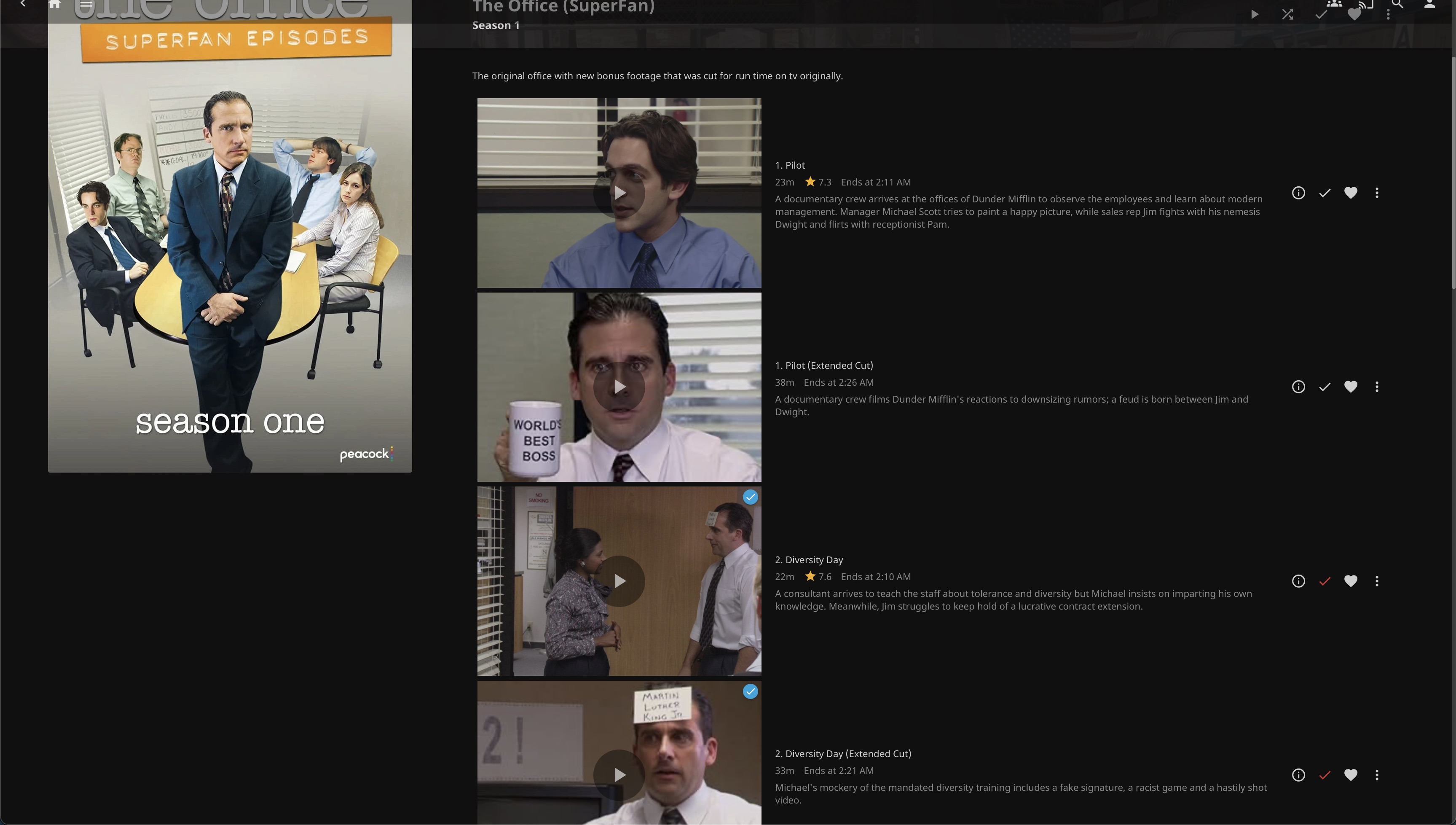

    I have 2 folders in my Tv Shows folder, one of them is called "The Office (US) (SuperFan) (2020) [tmdbid-250607]" and the other is called "The Office US (2005) [tmdbid-2416]".
    However, in Jellyfin, although there is 2 series for The Office and the Office SuperFan, when I enter either one of the series, all of the episodes appear right next to each other in the seasons.
    I am trying to keep the series completely separate and I don't know what else to do.
    I have tried identifying each series to their respective series and it does not change anything.
    Any help would be appreciated.
    Thank you!

    (2024-04-27, 03:38 PM)TheDreadPirate Wrote: Try renaming the SuperFan folder to "The Office SuperFan [tmdbid-250607]".  I'm wondering if the parentheses aren't being picked up as being part of the name so it just sees "The Office" and merges them.
    I tried this out. After letting Jellyfin do its thing it has ended up the same way as before.
    One file is named "The Office SuperFan [tmdbid-250607]" and the other is named "The Office US (2005) [tmdbid-2416]".
    They are both identified correctly in Jellyfin, but the episodes still appear in both series.

    I don't know why this specifically worked.
    But all I did was rename the superman folder to "The Office Superfan Episodes (2021) [tmdbid-250607]" and deleted the tvshow.nfo file in the folder and it fixed itself.
