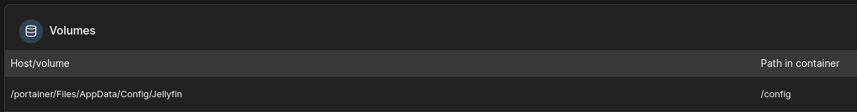

    You need to provide the path you configured in portainer where /config is mounted. Then add the log path.
    An example. You mounted /config at /docker/jellyfin/config. You'd provide this path to fail2ban.
    /docker/jellyfin/config/log
    LittleFluffyCloud
    2024-09-28, 06:50 PM (This post was last modified: 2024-09-28, 06:51 PM by LittleFluffyCloud. Edited 1 time in total.)
    So I guess for me it is this location as per portainer
    which when I navigate to has this folder location for jellyfin logs
    /portainer/Files/AppData/Config/Jellyfin/log
    which means my config should have this path
    logpath = /portainer/Files/AppData/Config/Jellyfin/log/jellyfin*.log

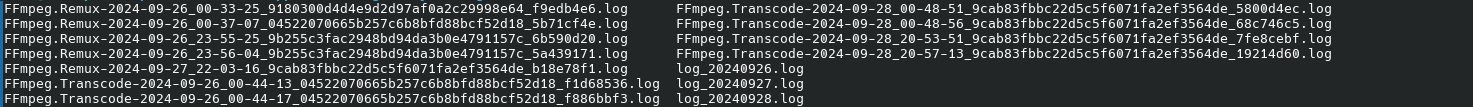

    So the issue was there weren't any logs that matched the specified regex at the log path. I created a file and fail2ban loaded. But when I ran the test regex it didn't work. Then I entered different regex for the logs that appear in the folder already
    then failed to log in 5 times on a test account and ran the test regex and got this result which I think means it didn't work
