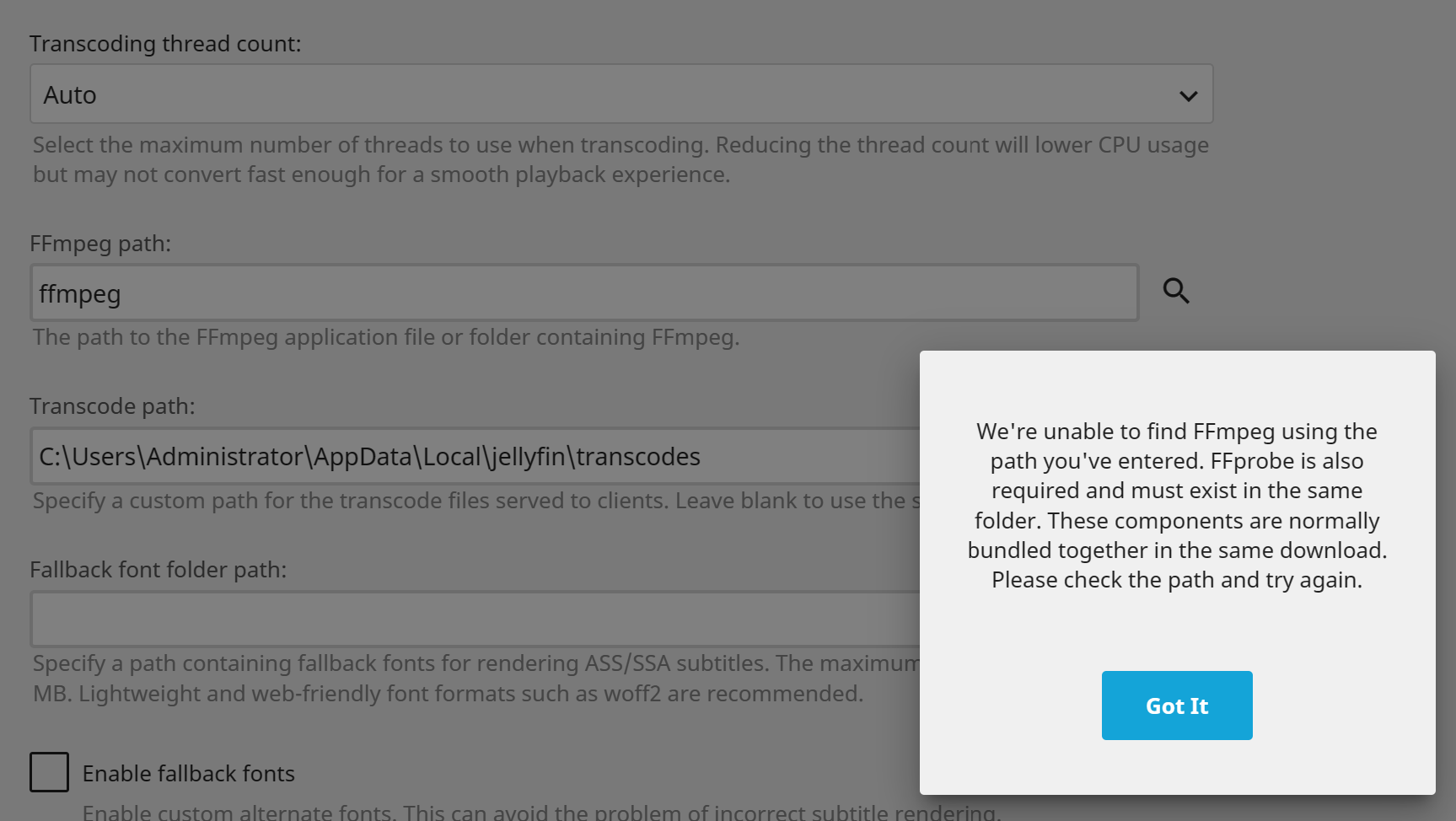

    For some reason when I checked the FFMPEG path it was empty by default. It's also not detecting several versions of FFMPEG when I select the path or even the actual FFMPEG.exe.
    I also tried most recent custom version by Jellyfin.

    It has this error since the first run so I thought it's actually missing and tried to add a path after downloading the FFMPEG which also errored Not Found.
    When I try to set it the jellyfin folder where the custom jellyfin FFMPEG is I get the same Not Found error.
    I can confirm the FFMPEG is there in the folder.

    The default path on windows should look as in the attached image. If this is how it's set, and it's still not able to find it, and you've verified that it's there, then there may be a larger issue with Windows or something we need to look at. But check to make sure that this is the path as configured first.
    It should simply say "ffmpeg" in the field.

    (2023-09-16, 07:49 PM)skribe Wrote: The default path on windows should look as in the attached image. If this is how it's set, and it's still not able to find it, and you've verified that it's there, then there may be a larger issue with Windows or something we need to look at. But check to make sure that this is the path as configured first.
    It wasn't there, the field was empty, I tried to put 'ffmpeg' in there and hit save. I'm getting the same error.

    And, to be clear, you have both ffmpeg and ffprobe in your jellyfin server folder as below, right?
    Manthan
    Posts: 7
    2023-09-16, 08:11 PM
    Absolutely
