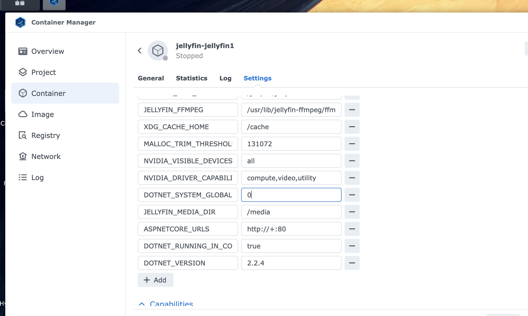

    I have been having a problem recently with Jellyfin 10.9 in a Docker container on my Synology NAS.
    The problem was that files added to the Libraries weren't being detected and library scanning seemed to keep failing.
    After a bunch of online searching I came across a discussion of this problem at https://github.com/jellyfin/jellyfin/issues/11528
    The fix for the problem seems to be changing the setting for DOTNET_SYSTEM_GLOBALIZATION_INVARIANT  from 1 to 0 in the configuration for the  Jellyfin container.
    My library scans are now working and all videos which were not playing properly are now working.
    I hope this will be useful for others with this problem.
