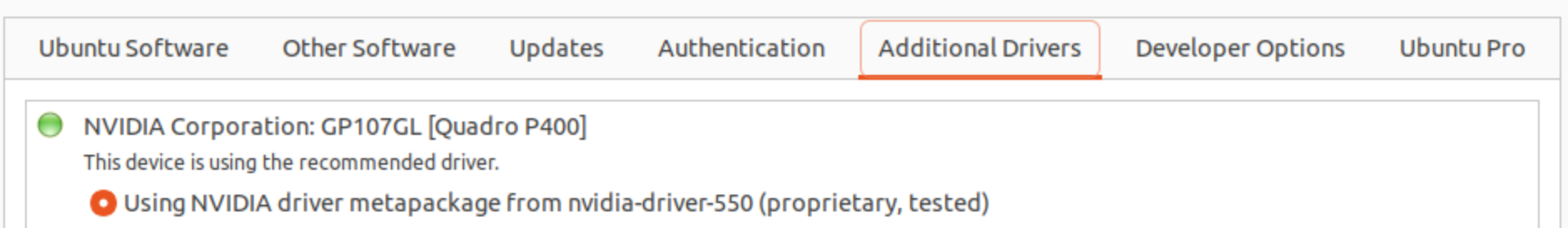

    I believe I have the nvidia-driver-550 installed (by checking ubuntu update-> additional Driver)

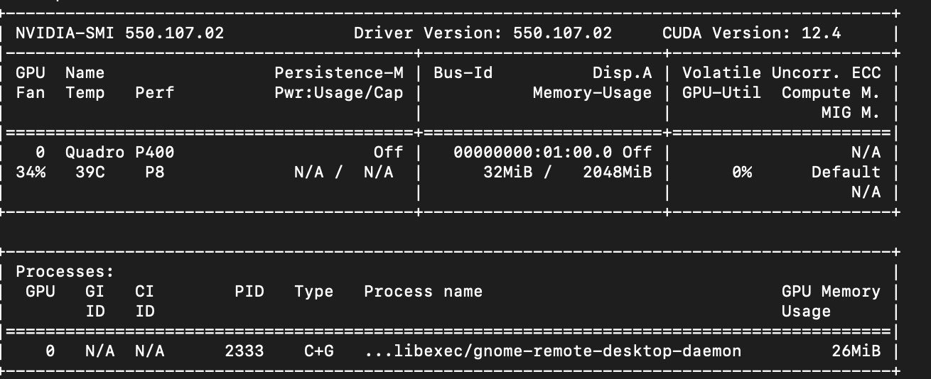

    When I run nvidia-smi I get this, which I believe is an indication that the driver is rightly installed:
    To verify that if I'm using hardware acceleration (or not), I'm using htop.
    When I have hardware acceleration (in Jellyfin) set to None, and I play a video, it all goes to 100% as expected.
    nvidia-smi doesn't show anything different.
    When I select Nvidia NVENC (with only HVEC 10bit and VP9 10bit UNselected) for decoding AND Hardware encoding options-> Enable hardware encoding UNselected, and I play a video, the CPU goes to ~100% like before, but I get a new line in nvidia-smi:
