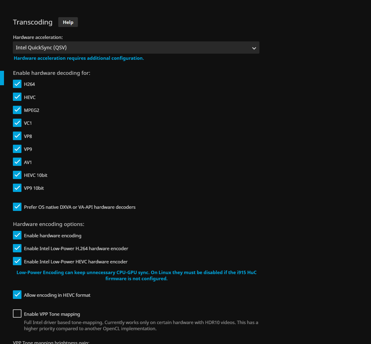

    Since the permission did not wanna work I re added the app and add the group directly and it seemed to have fixed it since I dont get a log server log file but the transcoder is now still broken.
    For extra Info I added my setting as shown in the dashboard.
    All settings below this screenshot are default. the "Prefer OS native DXVA or VA-API hardware decoders" also tested unchecked.
