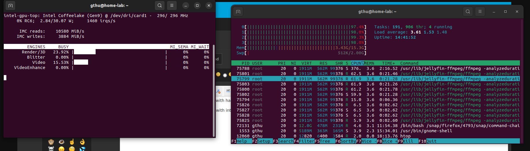

    Hey there im getting almost 100% CPU usage with hardware transcoding a single 4k hdr file to sdr 1080p.
    I have enabled QSV & and its working verified with intel_gpu_top & as well as logs, cleaned up the file to remove the subtitles, changed hdr tonemapping algorithm to mobius but nothing seems to be working.
    I have hp prodesk 600 g4 with i3 8100t. Should be transcoding multiple files at the same time as per my research.
    Have attached logs & screenshots. Any help would be much appreciated
    Also why is it even transcoding hevc to h264 when my client (Galaxy s23) can handle it well ?

    The QSV hardware decoder is not enabled.

    Well, yes it means the encoding to h264 is using the iGPU
    But that is not the only CPU intensive task. To be able to encode it needs to decode the existing file.
    By the log you posted it is  HEVC 10bit HDR content.
    So do you have hardware decoding enabled for HEVC 10bit in jellyfin?
    Even if you have it enable the file is HDR so it needs to have the Tonemapping done via software since hardware tonemapping is not supporting in Coffeelake CPU.

    We support OpenCL-based tone mapping for KabyLake and newer iGPUs. Coffeelake is no exception.

    VPP tonemap is also supported on KabyLake+. The only exceptions are Jasper Lake and some Gemini Lake processors.

    Hey guys
    When i enabled decoding for hevc it seems to be working (hevc 10bit was already enabled). Now the cpu usage sits around 30%.
    But why is it encoding to h264 when my client can handle h265 is it the issue with the android app ? Tried exoplayer also.
