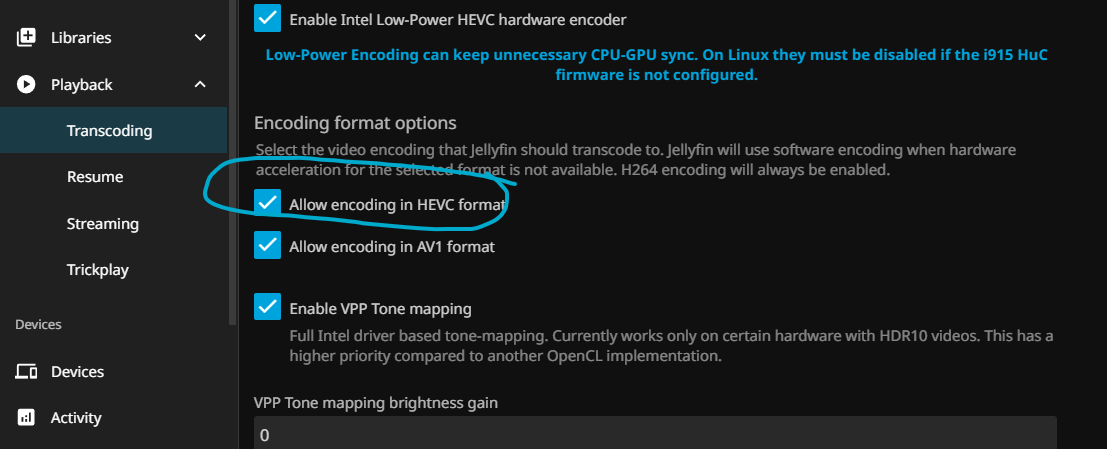

    Gtu785696
    Country:India
    2024-08-31, 03:38 PM
    (2024-08-31, 03:12 PM)TheDreadPirate Wrote: Did you enable HEVC encoding?
    "Allow encoding in HEVC format".
    Yes its enabled.
