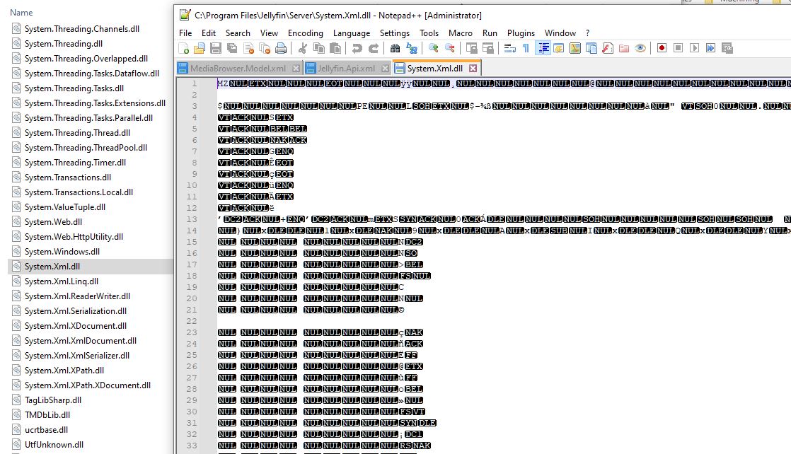

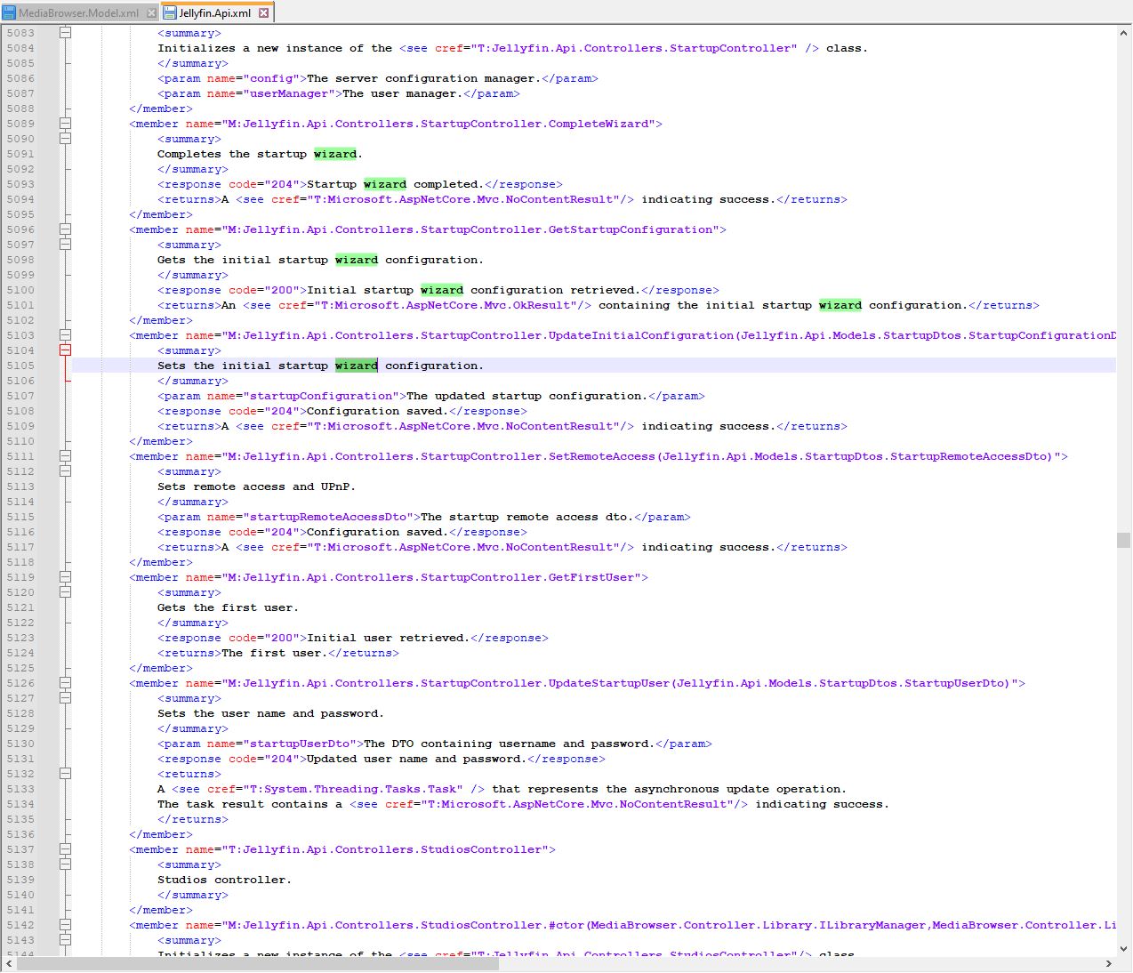

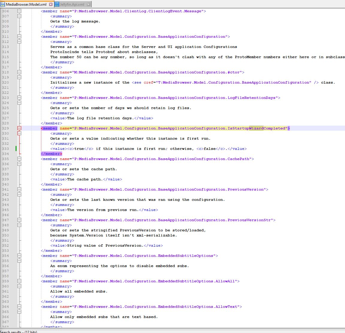

    these instructions are great, however I don't have a folder named "config"
    I did look through the existing xml files and when searching for "wizard" i couldn't find anything to change the flag from true to false. i did try to change the True on line 333 of mediabrowser.xml but it didn't do anything. the only other wizard entry is in the jellyfin.api.xml but no flags can be changed from what i can see.
    I also only see a system.xml.dll, that when i try to open is unreadable
    Thanks for all your help so far

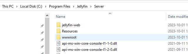

    2023-10-01, 10:50 PM
    C:\ProgramData\Jellyfin\Server\config
    Program data, not program files.
    jellyfintuna
    Joined: 2023 Oct
    2023-10-02, 02:00 AM
    yep that was it.
