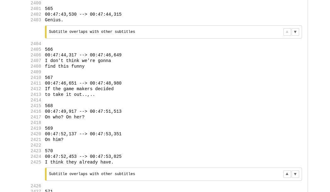

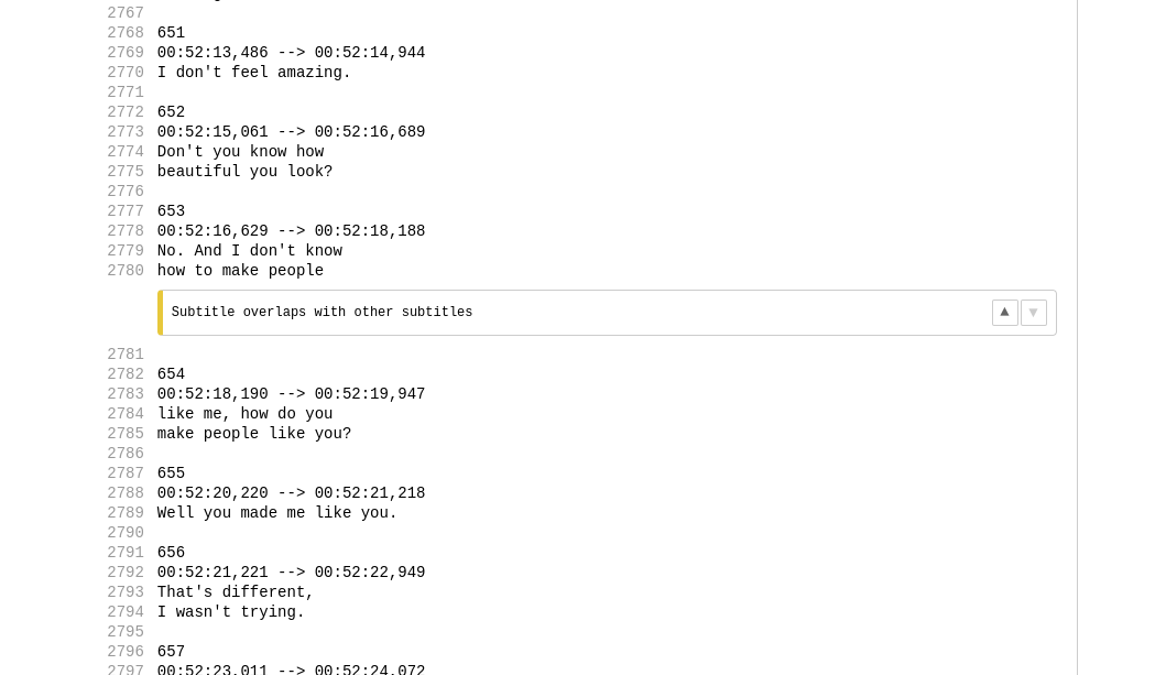

    There are two warnings when I run this sub through a validator.
    I placed the subs in a random movie and these warnings only caused the subs to stack or shift briefly.  So I doubt they are the issue.
