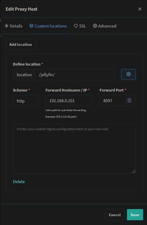

    Hello people,
    Recently, I cannot access Jellyfin from outside my home network.
    I just get a blank white page. My other service (CasaOS) works just fine, so it shouldn't be a port forwarding/DNS/firewall issue. I can also access Jellyfin just fine on my local network using the local ip, port and subpath. I've checked my jellyfin and nginx error logs and found nothing.
    I've attached my nginx proxy manager config
    Any help would be appreciated

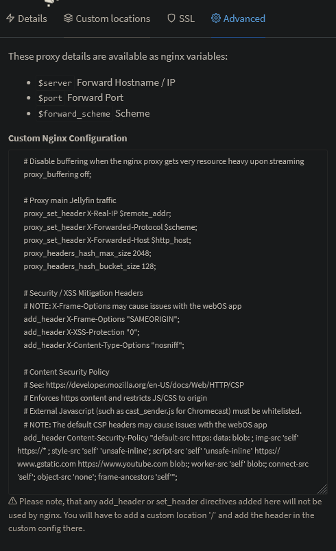

    2024-11-24, 03:23 PM (This post was last modified: 2024-11-24, 03:23 PM by TheDreadPirate.)
    Remove the custom location and add it under the advanced tab.
    Read this forum post for an example.
    https://forum.jellyfin.org/t-nginx-proxy...6#pid42446
    Updating the Nginx Proxy Manager documentation regarding sub-paths is on my to-do list.
    Serializ
    Joined: 2024 Nov
    2024-11-24, 03:43 PM
    It's working fine now, thank you
