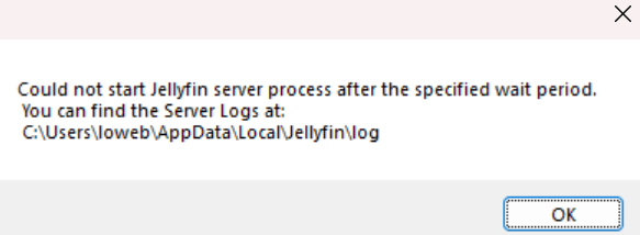

    Jellyfin Forum Support Troubleshooting SOLVED: Jellyfin Fails to start and defers me to logs
    Blaze
    Posts: 22
    2024-09-05, 08:23 PM
    Windows 11
    Jellyfin version 10.9.10
    Log information
    Prior to this XML issues were occurring         so I deleted and reinstalled Jellyfin before encountering this issue

    2024-09-05, 08:39 PM
    Holy mackerel, you have a lot of plugins.
    Try disabling the playback reporting plugin. Some other users, including myself, have had issues with that plugin causing Jellyfin to not start.

    2024-09-05, 09:34 PM (This post was last modified: 2024-09-05, 09:36 PM by Blaze. Edited 1 time in total.)
    SO I'm not entirely sure how to disable that without being able to open jellyfin so I deleted the folders and that did not seem to fix the issue

    2024-09-05, 10:53 PM
    You would have to go to C:\Users\loweb\AppData\Local\Jellyfin\plugins and remove the playback reporting folder. In that same directory there is a "configurations" folder. In it there should be an XML for the playback reporting plugin. Remove it.
    And in C:\Users\loweb\AppData\Local\Jellyfin\data you can rename the playback reporting database.
    Also, at any point did your disk fill up?

    2024-09-05, 11:10 PM (This post was last modified: 2024-09-05, 11:16 PM by Blaze. Edited 1 time in total.)
    Deleted the specified folders and renamed that file which sadly has not fixed the issue, but Yes actually. during the migration process I accidentally copied nearly the entire shows folder to my C drive and didn't notice till the lack of disk space error popped up but that was weeks ago so I'm unsure if that would be related but can send my logs since deleting and removing the playback reporter plugin

    2024-09-06, 02:34 AM
    I'm assuming some of your other plugins have their own database other than the playback reporting plugin. If possible, could you disable any other plugin that has its own database, by deleting the folders in the same manner, so that we can eliminate corrupt in plugin databases as the issue.
    I suggest this because a corrupt playback report database has prevented restarts from the dashboard from working properly (and I'm not alone with this issue). So I just want to eliminate those extraneous databases as the source of the fatal error.
    If after you've done this and it still fails to start, your main database may just be borked

    2024-09-06, 12:31 PM
    It does seem my main database is just dead in the water, so unless you have an easier solution in mind I may just need to switch to linux and restart. I've been looking for an excuse to wipe the drives on this device for a while anyways hehe...

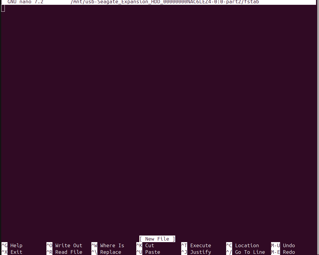

    2024-09-09, 11:40 AM
    So I have gotten Jellyfin up and running on the latest version of Unbuntu but am running into a permissions issue I have never faced before where it seems my mounted external NTFS drives don't have permission to be read by Jellyfin. I've tried changing my mount settings but it seems my 14tb partitions are being ignored regardless.
    If you aren't able to help I'll figure it out eventually, but it's been a couple years since I decided to use debian and I definitely am not as competent as I once was
    2024-09-09, 02:42 PM
    How did you mount your NTFS drive? Run this command and share the output.
    mount | grep ntfs
