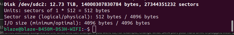

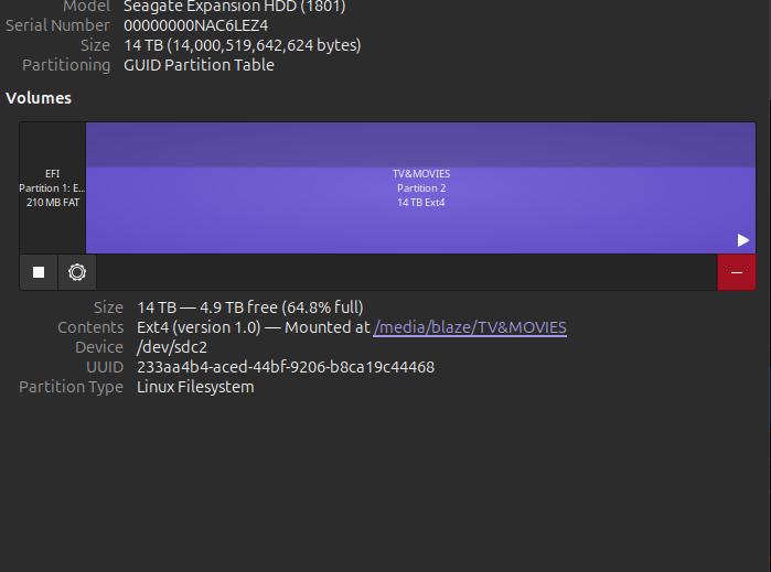

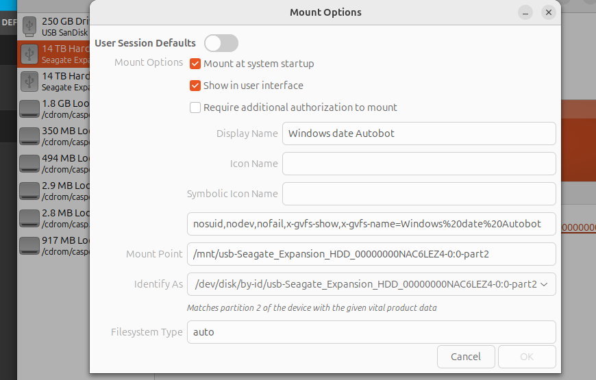

    2024-09-16, 05:58 AM (This post was last modified: 2024-09-16, 08:59 AM by Blaze. Edited 4 times in total.)
    Power cycled the system and everything works despite the errors. No clue how that fixed it, but thank you for all the help along the way
    I've been reading and working through the mounting guide, but I have gotten stuck on litterally the last step and was hoping you might be able to shed some light for me?

    blaze@blaze-B450M-DS3H-WIFI:~$ lsblk -o PATH,FSTYPE,MOUNTPOINT /dev/sdc2
    PATH FSTYPE MOUNTPOINT
    /dev/sdc2 ext4 /media/blaze/TV&MOVIES
    blaze@blaze-B450M-DS3H-WIFI:~$ sudo fdisk -x /dev/sdc2
    Disk /dev/sdc2: 12.73 TiB, 14000307830784 bytes, 27344351232 sectors
    Units: sectors of 1 * 512 = 512 bytes
    Sector size (logical/physical): 512 bytes / 4096 bytes
    I/O size (minimum/optimal): 4096 bytes / 4096 bytes

    Disk /dev/sdc: 12.73 TiB, 14000519642624 bytes, 27344764927 sectors
    Disk model: Expansion HDD
    Disklabel type: gpt
    Disk identifier: 01000000-0000-0000-4E41-43364C455A34
    First usable LBA: 34
    Last usable LBA: 27344764893
    Alternative LBA: 27344764926
    Partition entries starting LBA: 2
    Allocated partition entries: 128
    Partition entries ending LBA: 33
    Device      Start        End    Sectors Type-UUID                            UUID                                Name                Attrs
    /dev/sdc1      40      409639      409600 C12A7328-F81F-11D2-BA4B-00A0C93EC93B 81A5D46D-2DBF-455A-A3B5-7EF2BE05474C EFI System Partition
    /dev/sdc2  411648 27344762879 27344351232 0FC63DAF-8483-4772-8E79-3D69D8477DE4 4F2BB852-4E22-4A34-A814-E889FA93D2FE

    edit: Got the proper UUID for the partition and just need to figure out what is causing this command to fail UUID=233aa4b4-aced-44bf-9206-b8ca19c44468 /media/jellymount ext4 default 0 0
    bash: /media/jellymount: Is a directory
    #17
    2024-09-16, 03:15 PM
    The fdisk command shows that sdc2's UUID is 4F2BB852-4E22-4A34-A814-E889FA93D2FE. Try using that.
