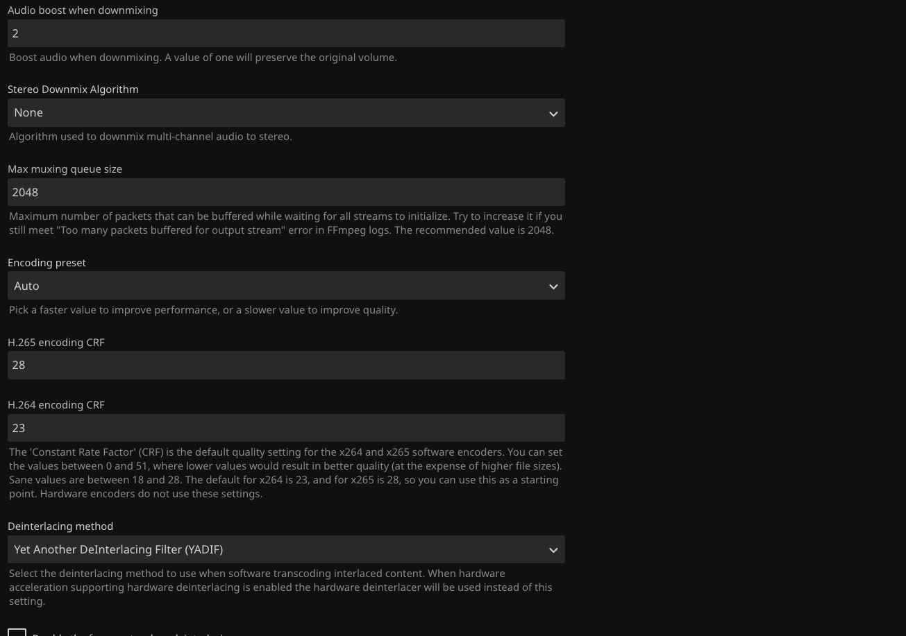

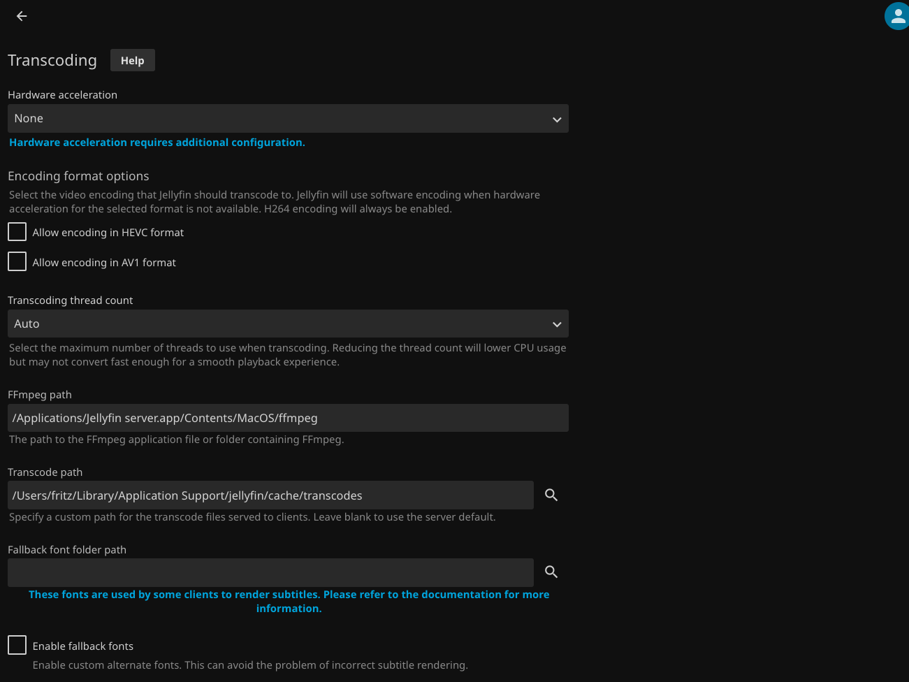

    #18
    2024-08-30, 09:46 PM
    Can you share the ffmpeg log associated with the failure? And screenshots of Dashboard > Playback.
