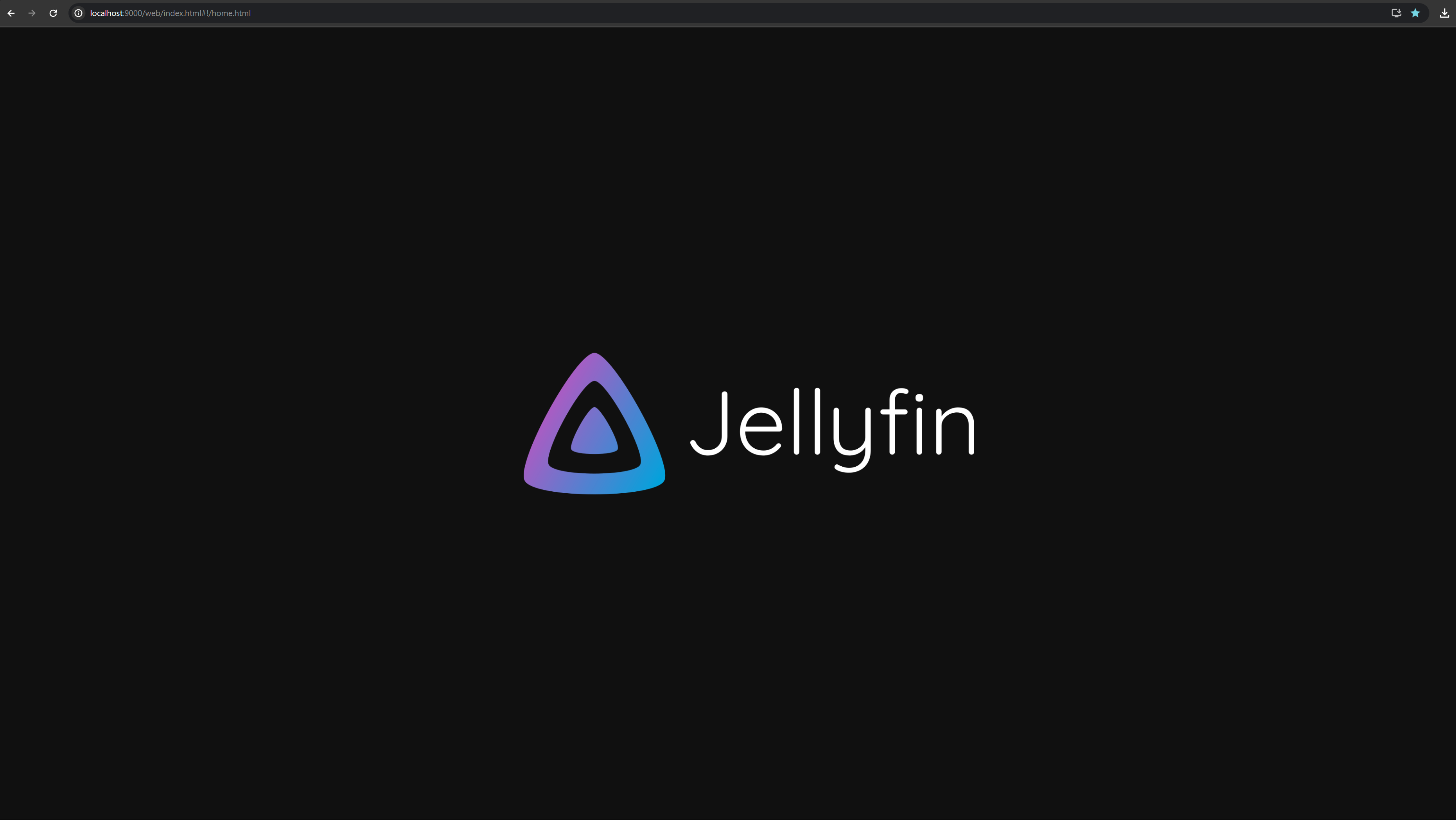

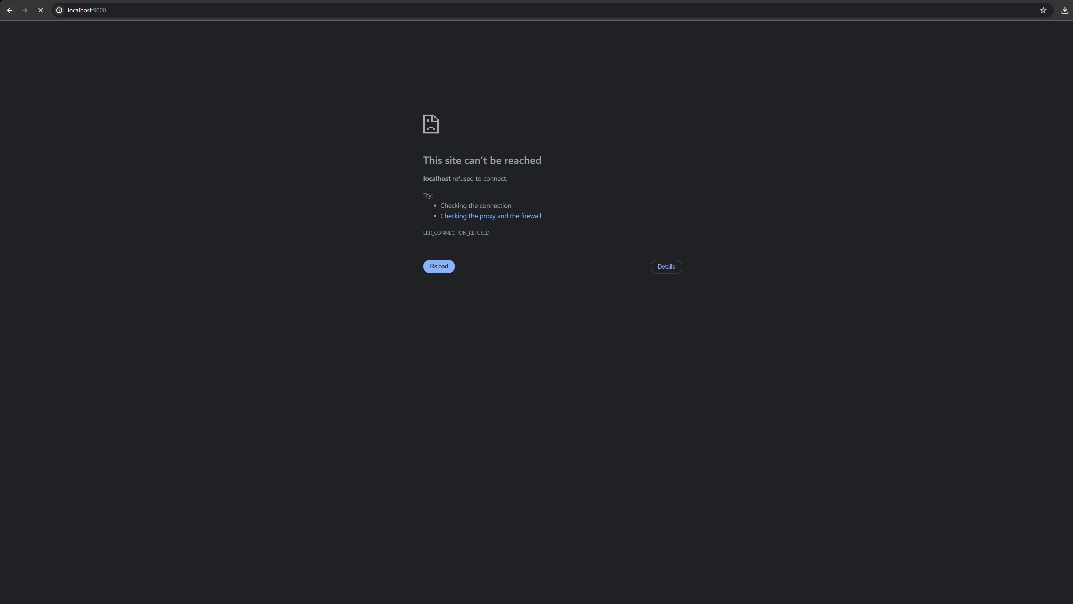

    I upgraded to Jellyfin 10.9.0 earlier today, and since then I have not been able to access the server. Whenever I try to go to the home.html page, which I have bookmarked, I just get a full page of the logo; See attachment. When I try to go to the regular locolhost:9000 page, I get a "This site can't be reached" error. When I try to connect to Jellyfin on any other device, I get a "Couldn't connect to server" message. I have the server running, and I double checked, and it's allowed through all of my firewalls, but I can't access it for some reason.
    I have since downgraded to Jellyfin 10.8.13, but I'm still getting the same error message. So, no I have no way to get into Jellyfin, and the update just broke the web server.

    I'm having the same issue as OP on a docker setup on a proxmox host. Just a big logo on the page and nothing else. docker logs -f doesn't show any activity.
    Never mind, clearing site data let's me log in again.
