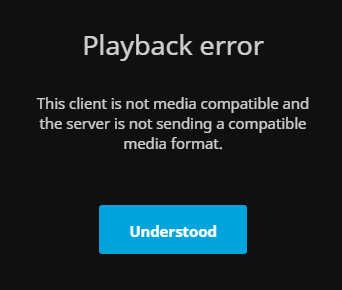

    Hello community!
    I have a problem with my Jellyfin Server.
    If i try to play an 4K movie (lets say Harry Potter) its returns me the following error: "This client isn't compatible with the media and the server isn't sending a compatible media format."

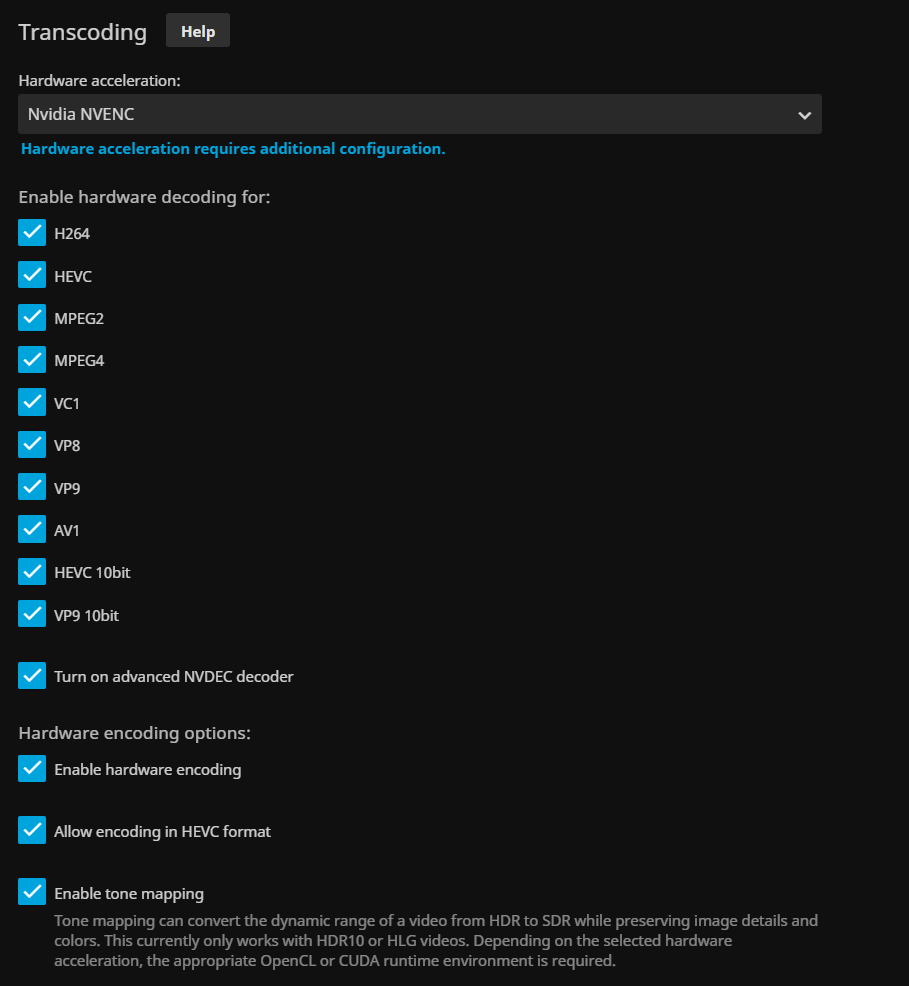

    2024-04-12, 01:02 PM
    Which client are you using and what resolution is the TV?
    Also, the codec check boxes in your screenshot are to tell Jellyfin which codecs your GPU supports DECODING. Your 960 does NOT support most of those.
    https://developer.nvidia.com/video-encod...matrix-new
    To be clear, if you uncheck them that just means the CPU will decode them, not that they won't play at all. And I don't think this is the cause of your problem because your GPU does support the 10-bit HEVC of this video.
    Check MPEG2, VP8, VP9, H264, HEVC, HEVC 10-bit. Uncheck the rest, also check tone mapping.

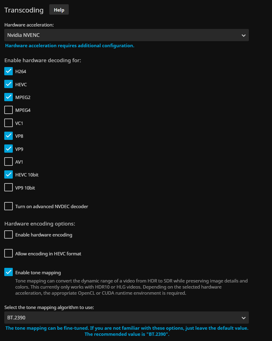

    (2024-04-12, 01:02 PM)TheDreadPirate Wrote: Which client are you using and what resolution is the TV?
    Hey there! I am trying to watch the videos via the Chrome Browser. I am accessing the server via the ip.
    The Resolution of my monitor is 2560x1440 @165Hz.
    I unchecked the things now. It still says the same error.
    I don't know what to do...
    .txt   Log.txt (Size: 33.52 KB / Downloads: 35)
    2024-04-12, 01:59 PM
    Oh. You didn't check "enable hardware encoding". I missed that the first time. This means it is CPU encoding. What happens when you check that?

    (2024-04-12, 01:59 PM)TheDreadPirate Wrote: Oh.  You didn't check "enable hardware encoding". I missed that the first time. This means it is CPU encoding. What happens when you check that?
    Can you share the jellyfin log? Not the ffmpeg log?
    I disabled that to test if it would make a difference, but seems like it is still not working.
