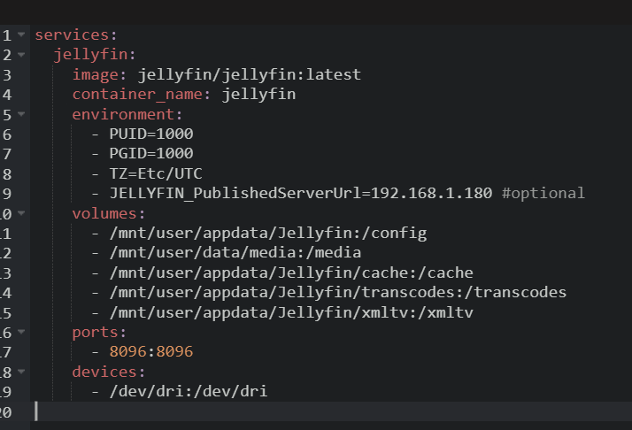

    #27
    2024-07-11, 10:08 PM
    Same thing is happening. I attached a screenshot of my set up

    #28
    2024-07-11, 10:18 PM (This post was last modified: 2024-07-11, 10:19 PM by TheDreadPirate. Edited 2 times in total.)
    Try adding this to the compose.
    network_mode: 'host'
        extra_hosts:
          - 'host.docker.internal:host-gateway'
    Edit: Accidentally clicked on "mark as solution" instead of edit.
    Meant to add that the code block isn't giving "network_mode" the correct indent. Should be the same as devices and ports. If you do use host networking, comment out the two lines for ports since they are no longer needed.

    2024-07-11, 10:22 PM
    Adding that to the compose still resulted in the same crash

    #30
    2024-07-11, 10:52 PM (This post was last modified: 2024-07-11, 10:52 PM by TheDreadPirate.)
    At this point, perhaps try asking on the Unraid forum. SOMETHING is configured in Unraid to bounce unhealthy containers, I just don't know where.
    I have an Unraid license and I plan on setting up a testing instance this weekend. So if the Unraid forums don't help, I'll circle back if I figure anything out with my test setup.
    https://forums.unraid.net/
