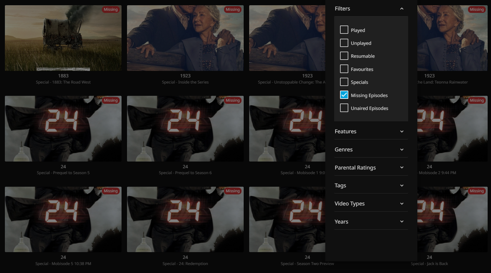

    Is there a way to show missing episodes but not specials? Also it would be good to be able to see on one place all missing episodes in your collection rather than having to go to the season to see what is missing. Is this possible anywhere?

    I can see that you should be able to filter and show both missing episodes and/or missing specials.  The problem is that when selecting missing episodes, all the specials show up as well.  I would just like to be able to see what actual episodes are missing from my collection.
