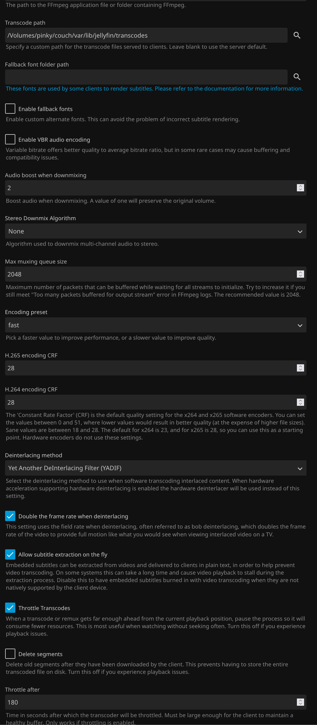

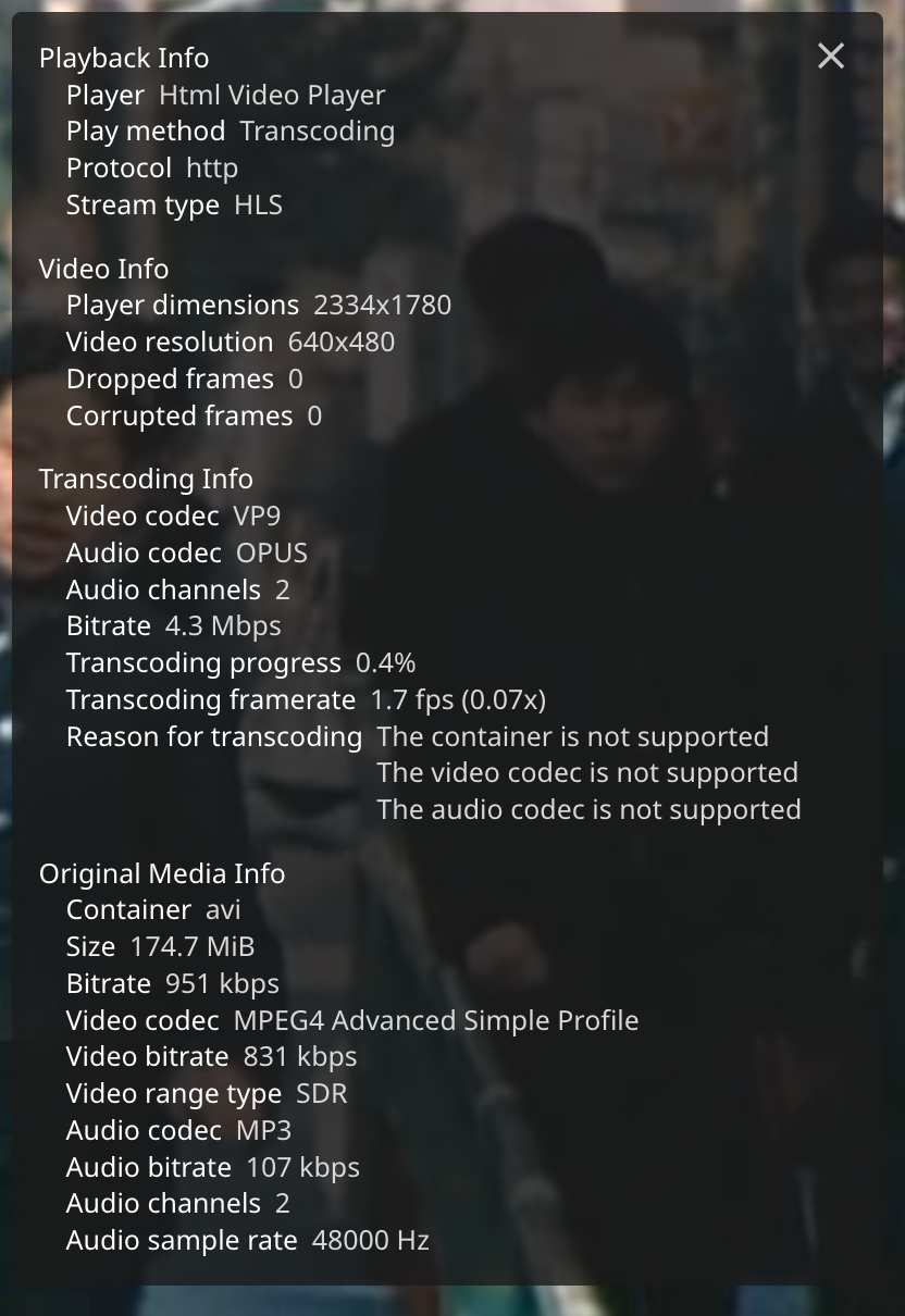

    Transcoding settings enable hardware decoding for everything. Hardware encoding is enabled. Under Encoding format options, I have only selected "Allow encoding in HEVC format". Still, in Chromium, playback will start after a short delay and then constantly stutter. Playback Info reveals that it's transcoding to VP9 and OPUS, for some reason, at 0.79x.

    Playback Info — https://imgur.com/a/kD2nL4H or attached
    VP1 transcoding speed is abysmal at 7% of realtime, although this is a low-end passive-cooled Intel Atom. The M1 reached about 80% of realtime. For comparison, the same M1 Mac encodes the same video at about 3x realtime in Handbrake using VP9 (medium, CQ25, default settings). Most of all, it should not be allowed to be transcoded to VP9.
