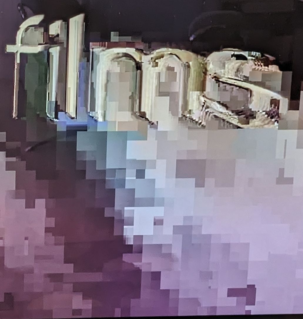

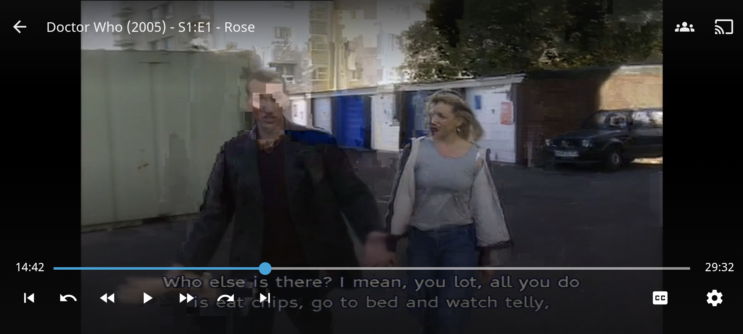

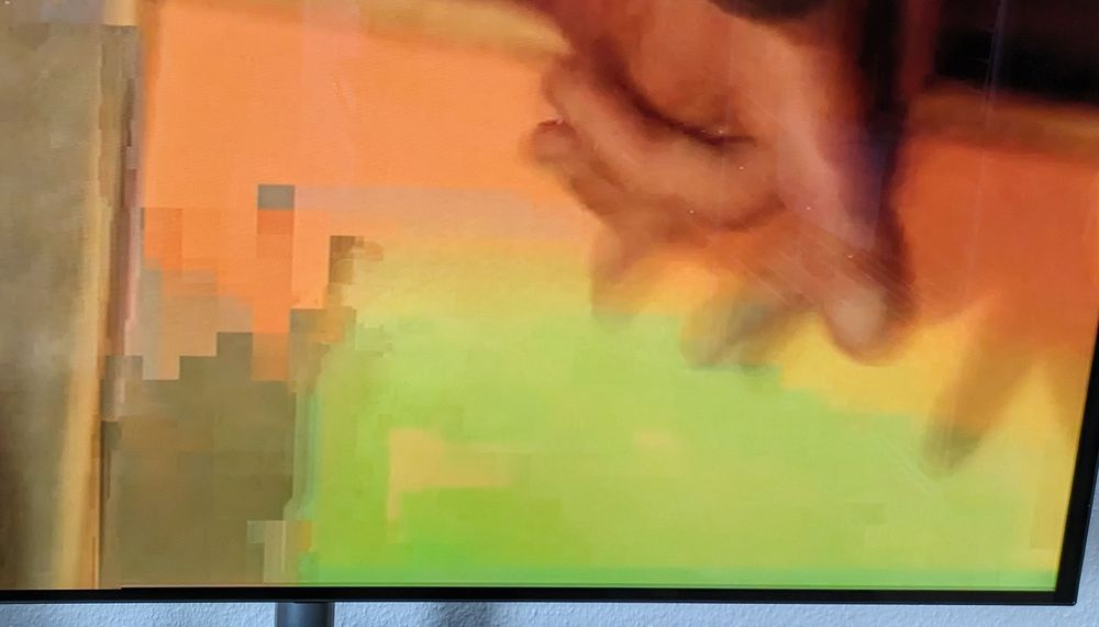

    Now I set up playback on Jellyfin's root account for VAAPI hardware transcode (all codecs except AV1). Unfortunately, when playing back (tested on an LG OLED w/ latest WebOS app and a Pixel 7a w/ the Android app), I encounter massive issues:
    1. The first transcode was done in H265, I think, and briefly froze every second or so
    2. I fiddled with some settings, e.g. "Allow encoding in HEVC format", and further encodes were in H264 (even after enabling the HEVC setting again?). Now, in addition to more irregular freezes, the image showed varying degrees of blocky artifacts, which sometimes took over most of the image.
    3. When disabling hardware transcoding, the image looks fine but CPU load increases, so it is not an ideal solution
    4. Switching to AMF instead of VAAPI just yields an error message when trying to play video (Playback Error - This client isn't compatible with the media and the server isn't sending a compatible media format)

    This was a "corrupted"/blocky H264 stream:
    /videos/b55a5ff3-90ab-0d57-618f-4918f11d3f7a/hls1/main/0.ts
    {"Protocol":0,"Id":"b55a5ff390ab0d57618f4918f11d3f7a","Path":"/video/Movies/Spy Caper.mkv","EncoderPath":null,"EncoderProtocol":null,"Type":0,"Container":"mkv,webm","Size":6868718592,"Name":"Spy Caper","IsRemote":false,"ETag":"fcf70906dab7532e9ec321a2205def95","RunTimeTicks":72222810112,"ReadAtNativeFramerate":false,"IgnoreDts":false,"IgnoreIndex":false,"GenPtsInput":false,"SupportsTranscoding":true,"SupportsDirectStream":true,"SupportsDirectPlay":true,"IsInfiniteStream":false,"RequiresOpening":false,"OpenToken":null,"RequiresClosing":false,"LiveStreamId":null,"BufferMs":null,"RequiresLooping":false,"SupportsProbing":true,"VideoType":0,"IsoType":null,"Video3DFormat":null,"MediaStreams":[{"Codec":"hevc","CodecTag":null,"Language":null,"ColorRange":null,"ColorSpace":"bt709","ColorTransfer":"bt709","ColorPrimaries":"bt709","DvVersionMajor":null,"DvVersionMinor":null,"DvProfile":null,"DvLevel":null,"RpuPresentFlag":null,"ElPresentFlag":null,"BlPresentFlag":null,"DvBlSignalCompatibilityId":null,"Comment":null,"TimeBase":"1/1000","CodecTimeBase":null,"Title":null,"VideoRange":"SDR","VideoRangeType":"SDR","VideoDoViTitle":null,"LocalizedUndefined":null,"LocalizedDefault":null,"LocalizedForced":null,"LocalizedExternal":null,"DisplayTitle":"1080p HEVC SDR","NalLengthSize":null,"IsInterlaced":false,"IsAVC":null,"ChannelLayout":null,"BitRate":7608364,"BitDepth":10,"RefFrames":1,"PacketLength":null,"Channels":null,"SampleRate":null,"IsDefault":true,"IsForced":false,"Height":800,"Width":1920,"AverageFrameRate":23.976025,"RealFrameRate":23.976025,"Profile":"Main 10","Type":1,"AspectRatio":"2.40:1","Index":0,"Score":null,"IsExternal":false,"DeliveryMethod":null,"DeliveryUrl":null,"IsExternalUrl":null,"IsTextSubtitleStream":false,"SupportsExternalStream":false,"Path":null,"PixelFormat":"yuv420p10le","Level":120,"IsAnamorphic":null},{"Codec":"opus","CodecTag":null,"Language":"eng","ColorRange":null,"ColorSpace":null,"ColorTransfer":null,"ColorPrimaries":null,"DvVersionMajor":null,"DvVersionMinor":null,"DvProfile":null,"DvLevel":null,"RpuPresentFlag":null,"ElPresentFlag":null,"BlPresentFlag":null,"DvBlSignalCompatibilityId":null,"Comment":null,"TimeBase":"1/1000","CodecTimeBase":null,"Title":"Surround 5.1","VideoRange":null,"VideoRangeType":null,"VideoDoViTitle":null,"LocalizedUndefined":null,"LocalizedDefault":null,"LocalizedForced":null,"LocalizedExternal":null,"DisplayTitle":"Surround 5.1 - Eng - OPUS - Default","NalLengthSize":null,"IsInterlaced":false,"IsAVC":null,"ChannelLayout":"5.1","BitRate":null,"BitDepth":null,"RefFrames":null,"PacketLength":null,"Channels":6,"SampleRate":48000,"IsDefault":true,"IsForced":false,"Height":null,"Width":null,"AverageFrameRate":null,"RealFrameRate":null,"Profile":null,"Type":0,"AspectRatio":null,"Index":1,"Score":null,"IsExternal":false,"DeliveryMethod":null,"DeliveryUrl":null,"IsExternalUrl":null,"IsTextSubtitleStream":false,"SupportsExternalStream":false,"Path":null,"PixelFormat":null,"Level":0,"IsAnamorphic":null},{"Codec":"PGSSUB","CodecTag":null,"Language":"eng","ColorRange":null,"ColorSpace":null,"ColorTransfer":null,"ColorPrimaries":null,"DvVersionMajor":null,"DvVersionMinor":null,"DvProfile":null,"DvLevel":null,"RpuPresentFlag":null,"ElPresentFlag":null,"BlPresentFlag":null,"DvBlSignalCompatibilityId":null,"Comment":null,"TimeBase":"1/1000","CodecTimeBase":null,"Title":null,"VideoRange":null,"VideoRangeType":null,"VideoDoViTitle":null,"LocalizedUndefined":"Undefined","LocalizedDefault":"Default","LocalizedForced":"Forced","LocalizedExternal":"External","DisplayTitle":"Eng - Default - Forced - PGSSUB","NalLengthSize":null,"IsInterlaced":false,"IsAVC":null,"ChannelLayout":null,"BitRate":null,"BitDepth":null,"RefFrames":null,"PacketLength":null,"Channels":null,"SampleRate":null,"IsDefault":true,"IsForced":true,"Height":null,"Width":null,"AverageFrameRate":null,"RealFrameRate":null,"Profile":null,"Type":2,"AspectRatio":null,"Index":2,"Score":null,"IsExternal":false,"DeliveryMethod":null,"DeliveryUrl":null,"IsExternalUrl":null,"IsTextSubtitleStream":false,"SupportsExternalStream":false,"Path":null,"PixelFormat":null,"Level":0,"IsAnamorphic":null},{"Codec":"PGSSUB","CodecTag":null,"Language":"eng","ColorRange":null,"ColorSpace":null,"ColorTransfer":null,"ColorPrimaries":null,"DvVersionMajor":null,"DvVersionMinor":null,"DvProfile":null,"DvLevel":null,"RpuPresentFlag":null,"ElPresentFlag":null,"BlPresentFlag":null,"DvBlSignalCompatibilityId":null,"Comment":null,"TimeBase":"1/1000","CodecTimeBase":null,"Title":null,"VideoRange":null,"VideoRangeType":null,"VideoDoViTitle":null,"LocalizedUndefined":"Undefined","LocalizedDefault":"Default","LocalizedForced":"Forced","LocalizedExternal":"External","DisplayTitle":"Eng - PGSSUB","NalLengthSize":null,"IsInterlaced":false,"IsAVC":null,"ChannelLayout":null,"BitRate":null,"BitDepth":null,"RefFrames":null,"PacketLength":null,"Channels":null,"SampleRate":null,"IsDefault":false,"IsForced":false,"Height":null,"Width":null,"AverageFrameRate":null,"RealFrameRate":null,"Profile":null,"Type":2,"AspectRatio":null,"Index":3,"Score":null,"IsExternal":false,"DeliveryMethod":null,"DeliveryUrl":null,"IsExternalUrl":null,"IsTextSubtitleStream":false,"SupportsExternalStream":false,"Path":null,"PixelFormat":null,"Level":0,"IsAnamorphic":null}],"MediaAttachments":[],"Formats":[],"Bitrate":7608364,"Timestamp":null,"RequiredHttpHeaders":{},"TranscodingUrl":null,"TranscodingSubProtocol":null,"TranscodingContainer":null,"AnalyzeDurationMs":null,"DefaultAudioStreamIndex":null,"DefaultSubtitleStreamIndex":null}
    /usr/lib/jellyfin-ffmpeg/ffmpeg -analyzeduration 200M -init_hw_device vaapi=va:/dev/dri/renderD128 -filter_hw_device va -hwaccel vaapi -hwaccel_output_format vaapi -autorotate 0 -canvas_size 1920x800 -i file:"/video/Movies/Spy Caper.mkv" -autoscale 0 -map_metadata -1 -map_chapters -1 -threads 0 -map 0:0 -map 0:1 -map -0:0 -codec:v:0 h264_vaapi -rc_mode VBR -b:v 12680607 -maxrate 12680607 -bufsize 25361214 -force_key_frames:0 "expr:gte(t,0+n_forced*3)" -flags:v -global_header -filter_complex "[0:3]scale=s=1920x800:flags=fast_bilinear[sub];[0:0]setparams=color_primaries=bt709:color_trc=bt709:colorspace=bt709,scale_vaapi=format=nv12:extra_hw_frames=24,hwdownload,format=nv12[main];[main][sub]overlay=eof_action=pass:shortest=1:repeatlast=0,hwupload_vaapi" -start_at_zero -codec:a:0 libfdk_aac -ac 6 -ab 640000 -copyts -avoid_negative_ts disabled -max_muxing_queue_size 2048 -f hls -max_delay 5000000 -hls_time 3 -hls_segment_type mpegts -start_number 0 -hls_segment_filename "/config/transcodes/247f5d845ec3e8421f52e804d98117a0%d.ts" -hls_playlist_type vod -hls_list_size 0 -y "/config/transcodes/247f5d845ec3e8421f52e804d98117a0.m3u8"

    Any ideas/recommendations where to start to try and fix this?

    I wanted to make sure it was not an issue with OMV or the docker setup. I installed Ubuntu (latest LTS) and the AMD drivers as per setup instructions. Unfortunately, the issue persisted even when running Jellyfin on "bare metal".
    Here's a log:

    I would assume this is an issue with either the drivers, FFMPEG or the APU, right?
    I know the older Ryzen APUs are supposed to have a very much sub-par H264 engine, but I can't believe it is that bad?
    2024-04-18, 08:06 PM
    My desktop has a RX6800, which I only run Jellyfin on for testing, and even the quality on that isn't great. Not as bad as your screenshots, but not too much better. Based on the screenshots other users have shared from their Ryzen APUs, what you are showing is not out of the oridinary.

    So, I did some more experimenting. I think the Athlon 200GE was not a good test case because it seems to do all encoding in software, which works on the 4650G too.
    I tried it on Windows. There, I had to use AMF. The results:
    • On my Server's Ryzen 4650G, it was unwatchably bad
    • On my notebook's Ryzen 4650U, it was fine (booted it off the same USB SSD as the server even)
    • On my PC's Ryzen 5600G, it was fine
    I also did some more testing on the 4650G. Often, it plays okay for some time before it starts to show artifacts, so I set a more aggressive fan curve, but that did not solve the issue. Even if the integrated GPU only reported ~35°C afterwards.
    There seems to be a correlation between the number of new or concurrent transcodes and appearance of artifacts. As far as I can tell, skipping in a video leads to a new transcode starting at the new position, and doing that a few times increases the likelihood of artifacts.
    Playing back more than one concurrent stream also leads to artifacts (and stronger ones) it seems.
    So either there is a defect in my Ryzen Pro 4650G's video encoder unit, but I have no idea how to test for that, or an incompatibility between it and one component of the Jellyfin transcode chain - but I would have thought that the 4650U and 5600G should be sufficiently closely related to be affected as well.
    I have run a Furmark stress test on the 4650G (w/ scan for artifacts, whatever that does), but I did not find any unusual behavior.
    Any ideas, what i could test next?
    P.S.: A typical case of a small artifact (the bird's wings, ca. at 03:00 seconds): https://dai.ly/x8xfjvo. And the same clip being played (and transcoded) on the 4650U w/o issues: https://dai.ly/x8xfjvm
