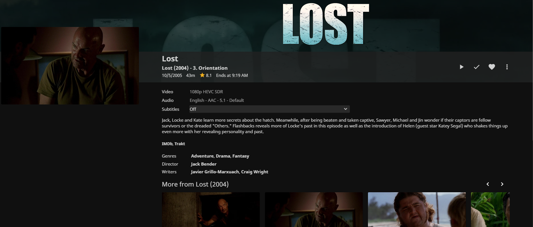

    I was trying to add Lost (2004) show to my library-

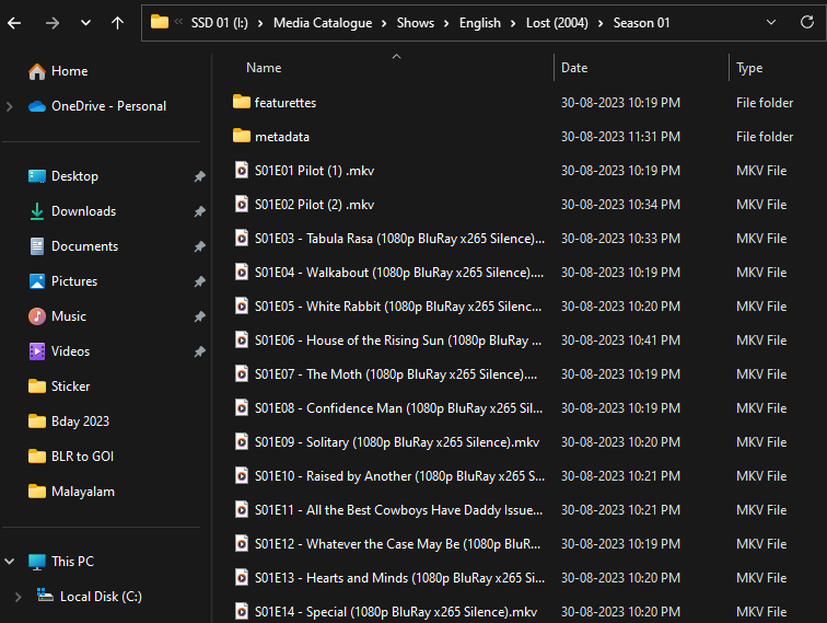

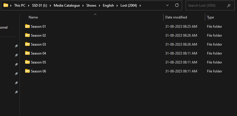

    I have created the media library as specified by the Jellyfin Guide - { Lost (2004) > Season 01 > S01E01 Episode name.mkv }  And so on

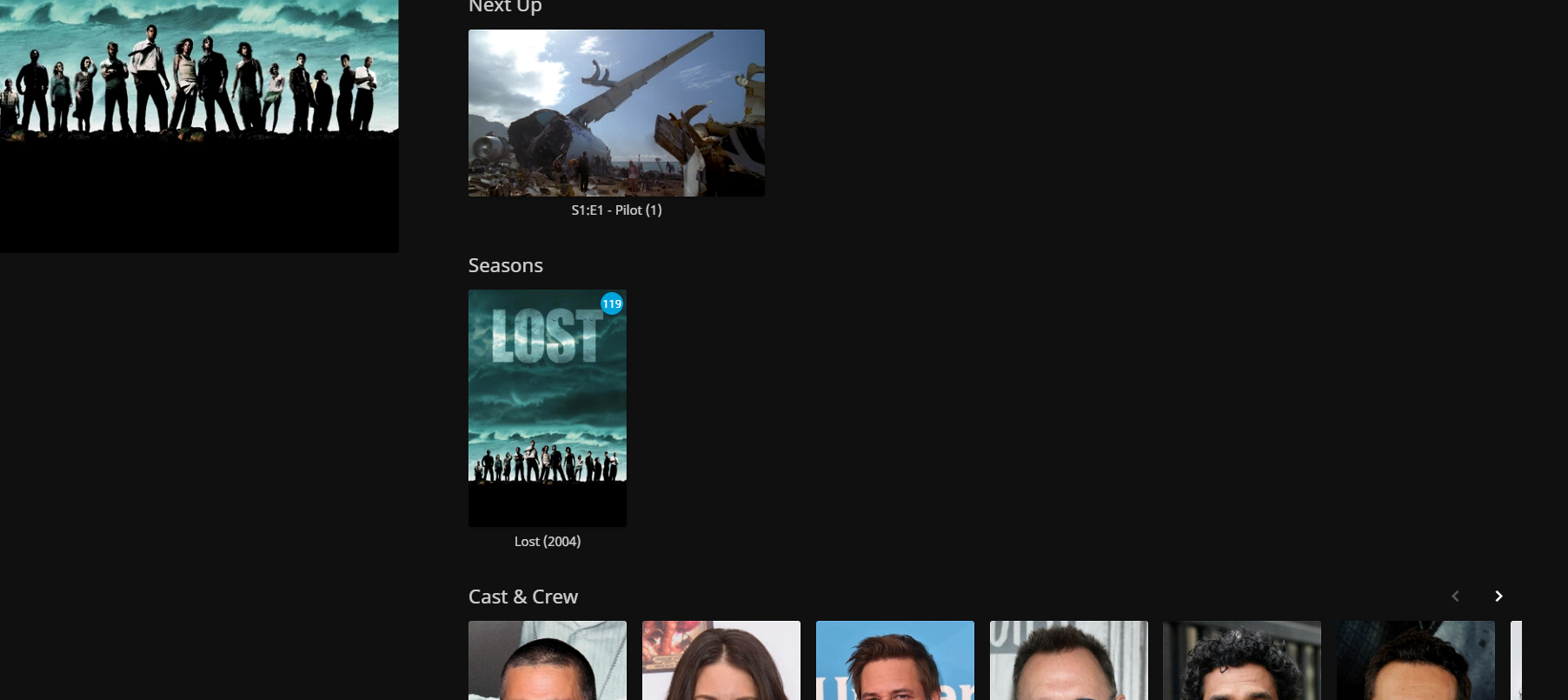

    In my Jellyfin library, I am not able to see these episodes as different seasons - However, all episodes are sorted correctly inside a single season. what is going on here?
    How can I resolve this?

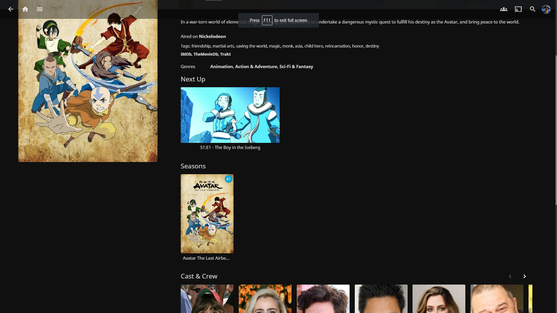

    The only way I was able to replicate this issue was by nesting my media an extra folder below where I pointed the library at.
    Library mounted here
    Quote:/media/extended/test/
    With my media 2 folders down
    Quote:/media/extended/test/test/Avatar The Last Airbender/s01e01.mkv

    I was directing the Jellyfin Shows library to "Media Catalogue>Shows "
    while lost was located at "Media Catalogue>Shows>English>Lost (2004)>Season 01" and so on.
    When I changed the Library to "Media Catalogue>Shows>English" The problam went away.  Seems like a wired behaviour
