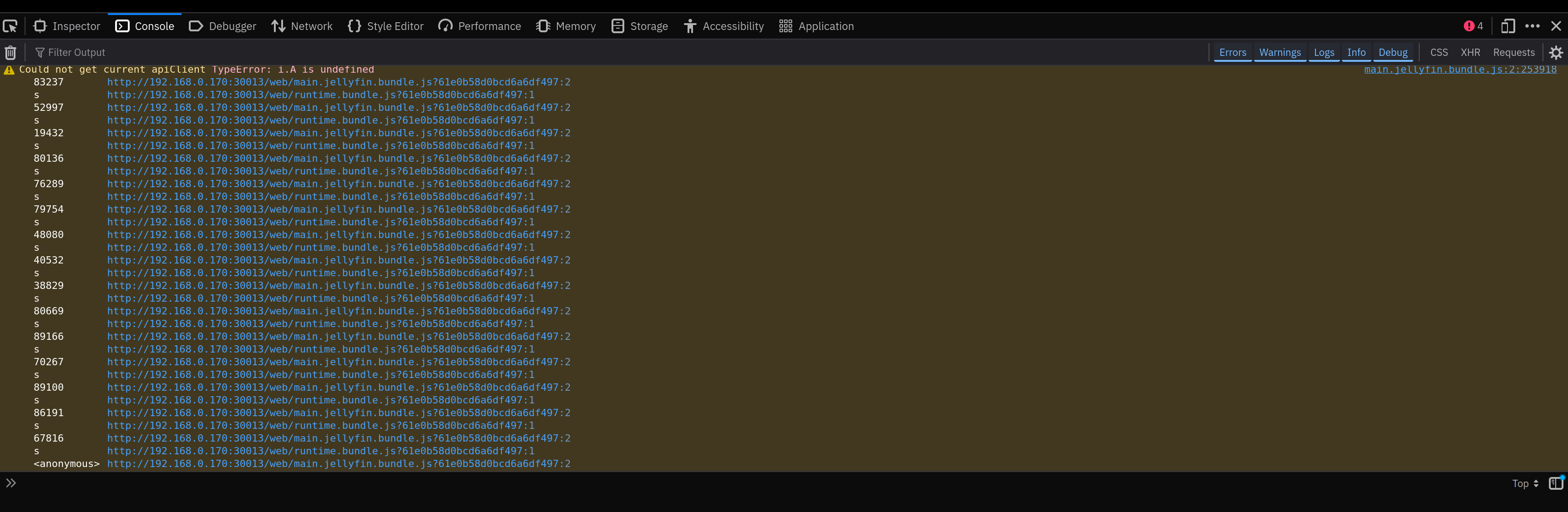

    Can you open a dev console in your browser, reproduce the problem, and look for any thing in the browser console messages that stand out.
    Also, are you using a reverse proxy?

    (2024-08-22, 07:27 PM)TheDreadPirate Wrote: Can you open a dev console in your browser, reproduce the problem, and look for any thing in the browser console messages that stand out.
    Currently accessing with wg VPN.
    Attached are the only things that looked interesting in the browser. Though admittedly I have no idea what I'm looking at.
