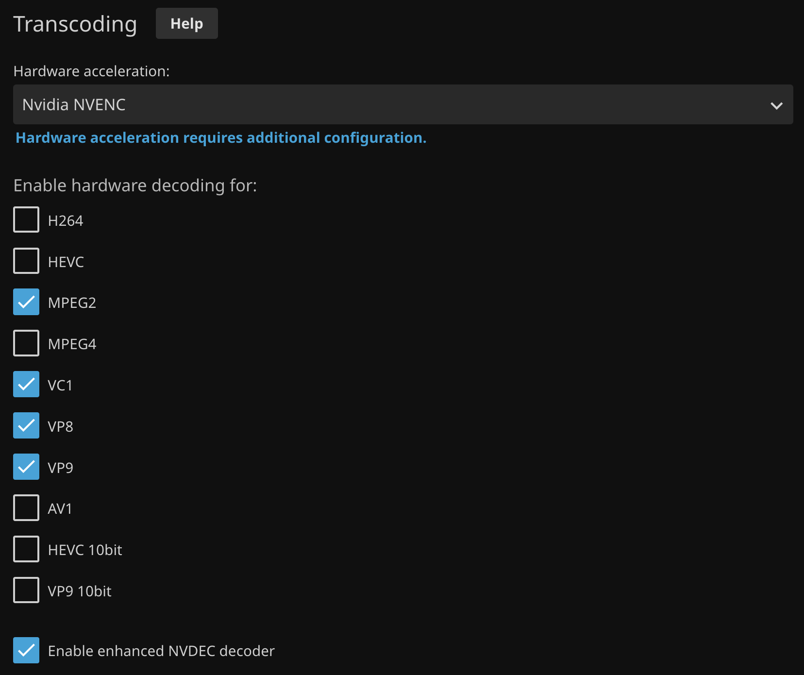

    The problem: Loading and seeking through jellyfin interface has become quite slow after nvidia driver install and HW acceleration
    Fresh install of ubuntu 23.04 and jellyfin. I attempted to install nvidia drivers initially but nvidia-smi threw an error saying it couldn't connect. This error notwithstanding, I was able to stream videos that looked great with near instant load and seeks with full HD audiotracks. The only issue I ran into was that MPEG2  and VC1 streams wouldn't load on many clients (though not all). Despite that, copying the URL and streaming from VLC always worked fine.
    I figured I needed to fix the HW acceleration issue and this would resolve the MPEG2 transcode, so I set about googling and realized I'd installed nvidia-utils-535-server rather than nvidia-driver-535-server. So I installed the drivers and poof nvidia-smi gave output. Yay. Likewise, I was able to solve the issues with MPEG2/VC1. Now, even a DVD MPEG2 film will take a few seconds to load and seeking can take a few seconds to load (same is true for HEVC/H264). Likewise, I've even unchecked the HEVC HW transcode tick box and the problem persists. Still copying the URL and streaming from VLC gives instant loads and seeks for 4K/DTSHD content.

    Gotcha, so I guess I'd just prefer the direct play then. Problem there is that MPEG2 and VC1 doesn't play on ipad/android clients. I've tried to uncheck the box for HW acceleration for HEVC but it still fires up the transcoding.
    I'm finding this in the log
    PlayMethod=Transcode, TranscodeReason=VideoCodecNotSupported, AudioCodecNotSupported for HEVC even after unchecking the transcode box.
    2023-10-25, 04:55 PM
    Those check boxes are for hardware accelerated DECODING and only apply when there is transcoding. Transcoding only happens when the CLIENT requests a transcode. When the client requests a direct play those check boxes don't matter.

    2023-10-25, 05:56 PM (This post was last modified: 2023-10-25, 05:59 PM by TheDreadPirate. Edited 2 times in total.)
    You want hardware acceleration on. Your server is probably CPU transcoding and going very slowly because your content is 4K according to the ffmpeg log.
    And what do mean "no dice" when using Swiftfin?
    For the decoding check boxes. Check everything except AV1.
    Check enhanced decoder
    Check allow encoding in HEVC. Save.
