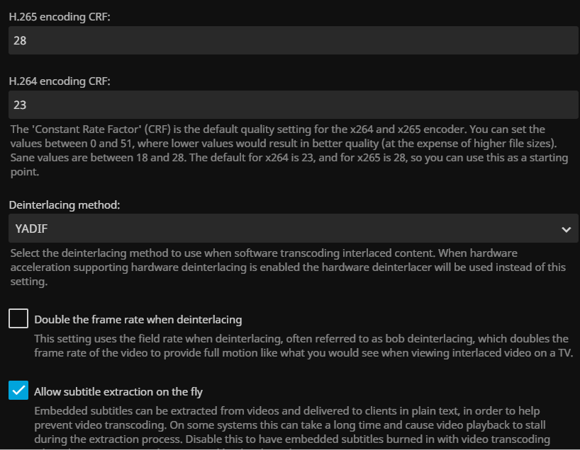

    Can you share screenshots of Dashboard > Playback? And what are your server specs?
    duckrental
    Posts: 30
    2024-01-19, 06:04 PM
    Screenshots attached. The server is an i5-3330 with 8 GB of RAM.
