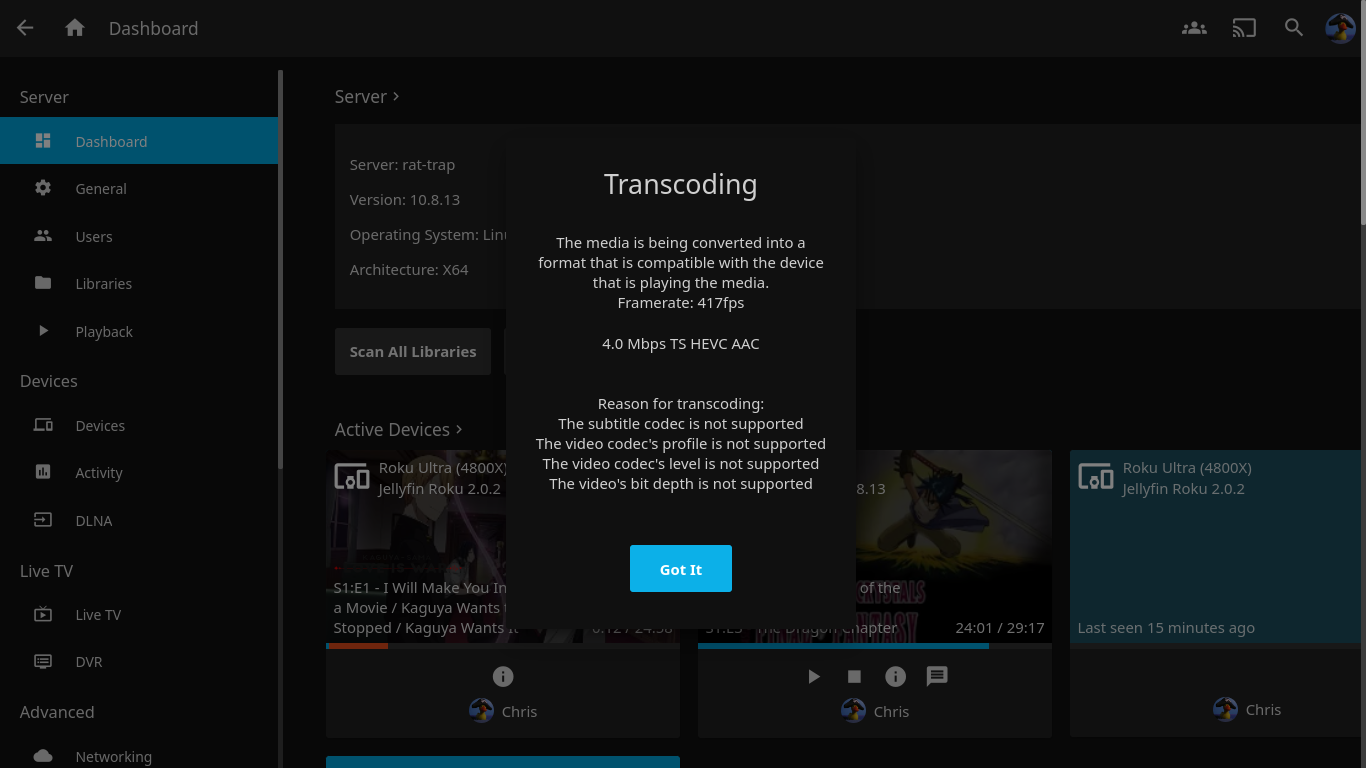

    TDP can you try without subtitles in your file, from your screenshot it needed transcode for video+subtitle
    in the log it works fine when that happens
    TranscodeReason=SubtitleCodecNotSupported, VideoProfileNotSupported, VideoBitDepthNotSupported
    but the failing file from the log only transcodes for
    TranscodeReason=VideoProfileNotSupported, VideoBitDepthNotSupported

    No change.  Still transcodes successfully without subtitles.
